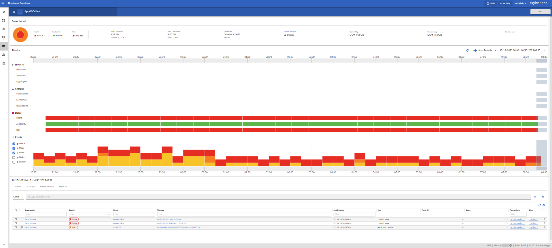

Viewing the Service Investigator
The Sections on the Service Investigator Page
The Service Investigator page contains the following sections:
  • Overview. A summary panel at the top of the page that displays organization and system information such as Contact Organization, Visible Organization, and Owner. This information bar also displays a preview of a sunburst chart, which you can click to see a more detailed breakdown of the Health, Availability, and Risk statuses of your devices.
  • Timeline. A panel that displays swim lanes and bar graphs to show Historical, Change, Health, Availability, Risk, and Skylar Automated RCA events. Swim lanes are visual flowcharts that show a process from start to finish for an event.
  • Events . An interactive pane that displays the Events, Changes, Service Analysis, and Skylar AI related to the service you have selected.

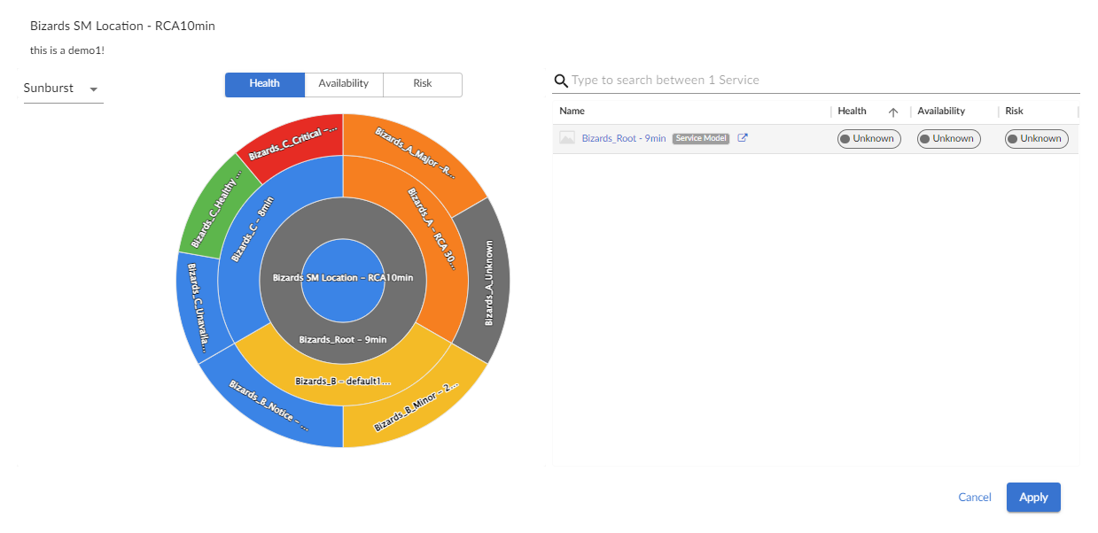

Sunburst View
The overview summary panel displays either a Sunburst chart view or a Map view of your services. Use the drop-down menu in the top left corner of the window to select which view you want to use.
When you select the Sunburst view:
  • The sunburst chart displays the current Health, Availability, and Risk values for the services, as well as for any constituent services or device services that belong to that top-level service. For device services, the sunburst chart includes the device name and health values for any devices that belong to the service. Additionally, this chart indicates the maximum number of constituent services or devices that will be used for computing health, availability, and risk.
  • The right panel includes a list of constituent services or devices. Each service in this panel includes icons that represent that service's Health, Availability, and Risk metrics; devices include icons that represent each device's health value. The right panel also includes a search bar at the top of the panel that enables you to search for specific constituent services or devices.
In the sunburst chart view, the center circle represents the selected service. The selected service drives the context for the page title and Info drawer, as well as all the other panels and widgets in the Overview section. This means that the right panel and other elements on the page will all reflect the metrics for the service in the center circle of the sunburst.
You can navigate through services on the widget in the following ways:
  • On the sunburst chart, you can click any constituent IT services or device services in the sunburst to select that service. To return to the parent IT service or business service, click the center circle or click the breadcrumb links that appear in the top-left corner of the window.
  • In the right panel, you can click the service name of any of the constituent IT services or device services to select that service. To return to the parent IT service or business service, click the breadcrumb links that appear in the top-left corner of the window.
By default, the sunburst displays the health value for the selected service and its constituent services or devices. To view the current availability or risk value for the selected service, click either the Availability or Risk tab above the sunburst chart.

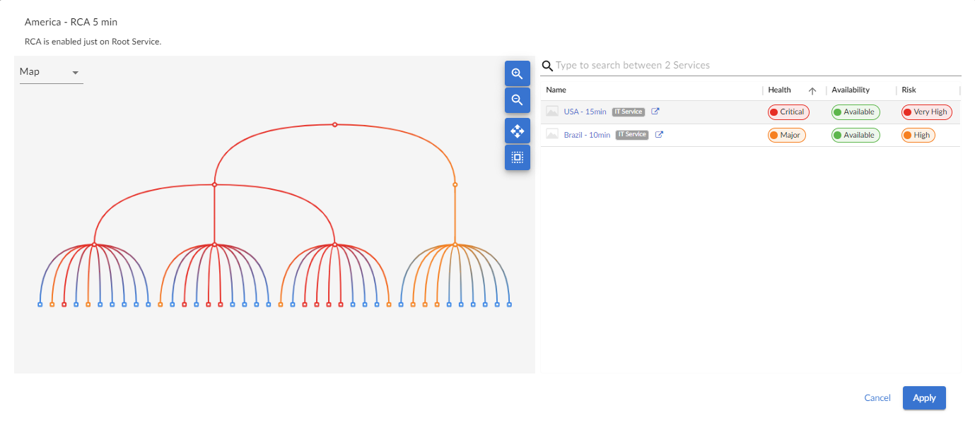

Map View
When you select the Map view:
  • The map view displays a map of the service and any constituent services and devices that belong to that top-level service.
In the map view, you can click on the top-level service or any of its constituent services or devices. The selected service drives the context for the page title and Info drawer, as well as all the other panels and widgets on the overview summary pane. This means that the right panel, and other elements on the page will all reflect the metrics for the service that you have clicked in the map view.
In the map view, use the following buttons to manipulate the map in the left pane:
: Zoom in on the map.
: Zoom out on the map.
: Fit all elements of a map into the viewing pane.
: Center all selected elements of a map in the viewing pane.
The viewing pane displays the following two types of graphical elements:
  1. Nodes that represent devices, topology elements, and business services defined in Skylar One. The shape of the node represents its type: Services, such as business services, IT services, or device services, are represented by hexagons, while devices are represented by squares. The color of the outline specifies the current state of the node.
  2. Edges are lines that represent the relationships and hierarchies between nodes.
When you hover over a node, a pop-up Properties pane appears with the metadata for that node. Click the Go to service or Go to device link at the top of the pane to open the Investigator page for that service or device in a new browser window.

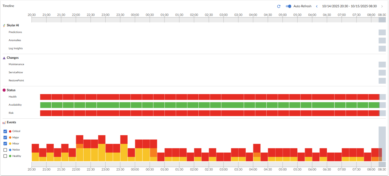

The Timeline Panel
The Timeline panel displays an interactive graphic that combines swim lanes and bar graphs to visualize the health, availability, and risk of your events. Swim lanes act as visual flowcharts, showing the progression of an event from start to finish. You can select any time range on the timeline to view Changes, Health, Availability, and Risk details specific to your device or service for that period. Timeline data is presented in 12‑hour segments, allowing you to navigate backward and review up to seven days of historical activity.
The Timeline panel consists of the following sections:
Starting in the AP2 Nougat release, the Skylar AI heading under the Timeline panel is renamed to Skylar Advisor. Starting in the AP2 Pancake release, the Skylar AI heading in the Events panel is reverted back to Skylar AI.
The swim lanes under the Skylar AI and Changes sections automatically expand or collapse based on configuration, subscription, and event availability. Each section collapses when it is not applicable or when no relevant events exist in the selected time frame, and expands automatically when events are present. The Skylar AI and Changes sections can also be manually collapsed or expanded. This automatic expand and collapse behavior is available starting in the AP2 Pancake release.

Status Swim Lanes
The Status section provides an overview of your service or device health, availability, and risk. Selecting a time range in the Timeline panel opens a pop‑over modal with Health, Availability, and Risk details for the selected device or service. By default, the status shows the health, availability, and risk statuses of events from the past 12 hours, which is the maximum supported time range.
Health
The Health swim lane displays device or service health over a period of time.
This swim lane indicates the current status of a device service—for example, the rate of processing or throughput for the devices in the service. In the case of Skylar One Database Servers, the "Rows Behind" value can provide a good measure of how effectively the Database Server is processing data from Data Collectors. Health is represented by a color-coded "severity" icon that corresponds to a numerical value between 0 and 100. For example, the Health value could indicate when a device is intermittently unavailable because of a power problem, thereby falling below the required level of performance. Health uses the following icons:
Availability
The Availability swim lane shows the availability status of your device or service over a period of time.
The availability of a device service is derived from the availability rules. This might or might not be linked to device availability. A service or device is considered unavailable if Skylar One is not able to collect data from the device or service, or if a device is usable or not usable. A value of 0 means a device or service is unavailable, and a value of 1 means a device is available. Availability uses the following icons:
Image Availability icons
Risk
The Risk swim lane displays the risk status of your device or service over a period of time.
This swim lane measures the risk status of your device or service using a percentage value between 0 and 100 that indicates how close a service is to being in an undesirable state. Use risk for data that is known to cause issues if left unchecked, such as critical events, swap usage, or low database logging space. The safest possible risk value is 0%, while the worst risk value is 100%.
These values are computed in this order because Skylar One uses Availability values to compute Health, and then uses both Availability and Health values to compute Risk.
Events Swim Lanes
The Events section contains five swim lanes that display the number of unique events of each severity level that impacted your service or device over a period of time. By default, the events cover the last 12 hours.
