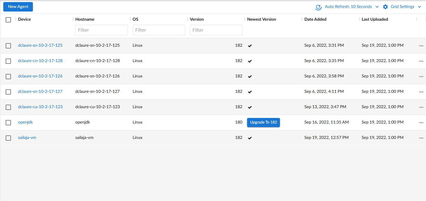

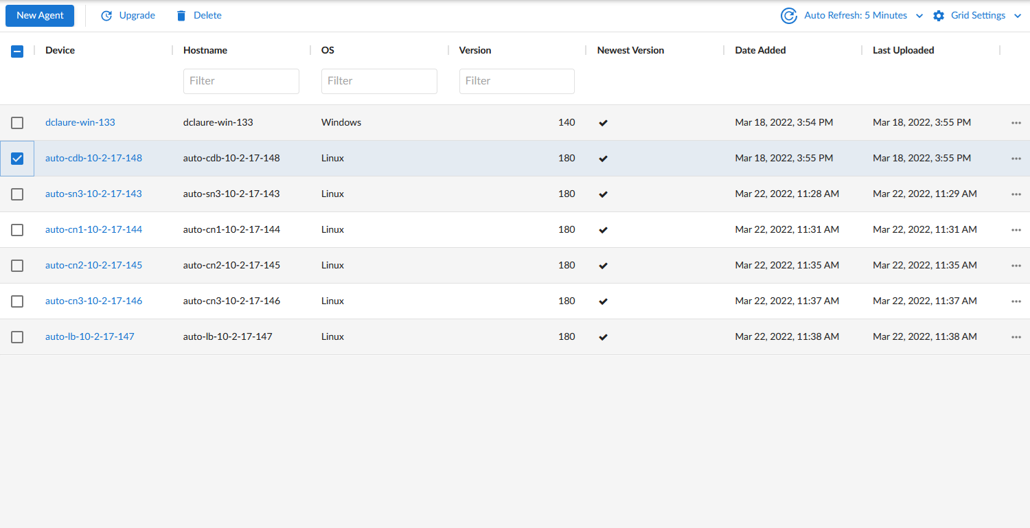

Installing an Agent from the Agents Page
When running Skylar One on the Skylar One Extended Architecture, you can use the Agents page (Devices > Agents) to help you install the Skylar One agent on a Linux, Windows, AIX, or Solaris device.
You can also upgrade and delete agents from Skylar One on the Agents page.
The Agents page appears as an option on the Devices menu only when you are using the Skylar One Extended Architecture. If your version of Skylar One does not have an Agents page, see Installing an Agent from the Device Manager Page.
If you are using a Skylar One system with the Skylar One Extended Architecture, you must use the Agents page (Devices > Agents) to install agents, including AIX and Solaris agents. AIX and Solaris agents are not available for non-Skylar One Extended systems.
If you want to remotely install one or more agents, see Remotely Installing a Skylar One Agent.
You do not install the agent from the Agents page itself. Instead, the Agents page enables you to gather the information or files you need to then install the agent on a particular device.
The instructions on the relevant tab of the Agents page also include command line parameters such as URLFRONT, which is used to define the Streamer service you are using as part of the Skylar One Extended Architecture.
If the agent installation is successful, one of the following automatically happens:
  • If the primary IP address of the device is not currently monitored by Skylar One, then Skylar One creates a device record for the device and populates the device record with data provided by the agent. The device record is assigned a device class based on data reported by the agent.
  • If the primary IP address of the device is currently monitored by Skylar One, the device record for the existing device is updated with data provided by the agent.
During initial discovery, the agent returns operating system type and version information to Skylar One. Based on this information, Skylar One assigns the corresponding device classes to a device monitored only by an agent. If a device is monitored by an agent and via SNMP, the device class assigned by SNMP discovery will take precedence.

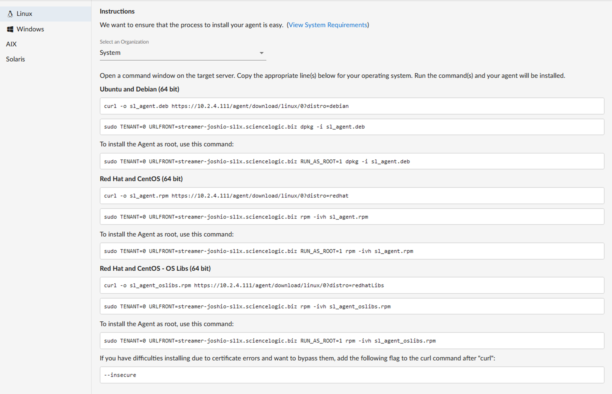

Installing a Linux Agent
For a Linux system, the Agents page (Devices > Agents) provides version-specific commands that you will need to run on the Linux system you want to monitor. This page includes commands for the following operating systems:
  • Ubuntu and Debian (64-bit)
  • Red Hat and CentOS (64-bit)
  • Red Hat and CentOS - OS Libs (64-bit)
Linux agent version 196 is the minimum version required for Skylar One 12.5.1.
The Linux agent installation program checks for the relevant version of libcurl before installing the agent. If libcurl is not installed, the agent installation program installs the most recent version of libcurl.
Skylar One supports the use of proxy server connections when using the agent on Linux systems. For more information about installing and configuring a Linux agent with a proxy server, see Configuring the Linux Agent to Use a Proxy.
Beginning with Linux Agent version 184, by default the agent will install and run as a dedicated non-root user with the user name "scilog". To run the Linux agent as root, use the installation command which includes RUN_AS_ROOT=1. This configuration has the following limitations:
  • Process data is only Non-Intercepted Process Data (NIPD). There are no intercepts or library data.
  • Polled Data only works for the current user.
  • Log files can only be monitored if they are readable by the scilog user or scilog group.
  • You cannot upgrade the agent from the Skylar One user interface because the installation and uninstallation processes require root privileges.
If you are installing on SELinux, see Using Agents with SELinux.

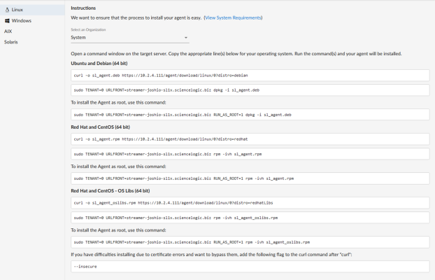

To install a Linux agent:
  1. On the Agents page (Devices > Agents), click New Agent. The Agent Installation page appears:
    Image of the Install a Linux Agent page
  1. Click the Linux tab at top left.
  2. From the Select an Organization drop-down list, select an organization for the device on which you are installing the agent. The TENANT value in the commands on this page is updated with the Skylar One Organization ID for the organization you selected.
    The URLFRONT value is the URL for the Streamer service you are using as part of the Skylar One Extended Architecture.
  3. Based on the version of Linux running on the device you want to monitor, run the relevant commands from the Linux tab on the Linux device (the "target server"). After the commands complete, the Linux agent starts running in the background. The device on which you installed the agent appears on the Agents page (Devices > Agents), and the device is also added to the list of devices on the Devices page.
You can also install the Linux agent via the command line.
To install the Linux agent (Debian or Ubuntu) using the command line, execute the following command:
sudo TENANT=<organization id> URLFRONT=<streamer_URL> dpkg -i sl_agent.rpm
  • TENANT and URLFRONT are required.
  • The RUN_AS state can be set via command line with RUN_AS_ROOT=<0|1>.
  • The default RUN_AS state is "scilog" when there is no command line RUN_AS_ROOT=X parameter given.
To install the Linux agent (RHEL or CentOS) using the command line, execute the following command:
sudo TENANT=<organization_id> URLFRONT=<streamer_URL> rpm -ivh sl_agent.rpm

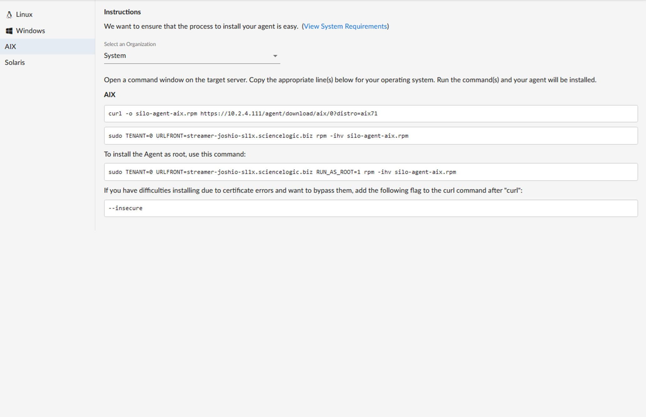

Installing an AIX Agent
Beginning with AIX agent version 184, by default the agent will install and run as a dedicated non-root system user named "scilog". To run the AIX agent as root, use the installation command which includes RUN_AS_ROOT=1.
For an AIX system, the Agents page provides a set of commands that you will need to run on the AIX system you want to monitor.
AIX agent version 196 is the minimum version required for Skylar One 12.5.1.
To download and install an AIX agent:
  1. On the Agents page (Devices > Agents), click New Agent. The Agent Installation page appears.
  2. Click the AIX tab:
    Image of the Install an AIX Agent page
  3. From the Select an Organization drop-down list, select an organization for the device on which you are installing the agent. The Tenant value in the commands on this page is updated with the Skylar One Organization ID for the organization you selected.
    The URLFront value is the URL for the Streamer service you are using as part of the Skylar One Extended Architecture.
  4. Run the relevant commands from the AIX tab on the AIX device (the "target server"). After the commands complete, the AIX agent starts running in the background. The device on which you installed the agent appears on the Agents page (Devices > Agents), and the device is also added to the list of devices on the Devices page.
You can also install the AIX agent via the command line by executing the following command:
sudo TENANT=<organization_id> URLFRONT=<streamer_URL> rpm -ivh sl_agent_aix.rpm

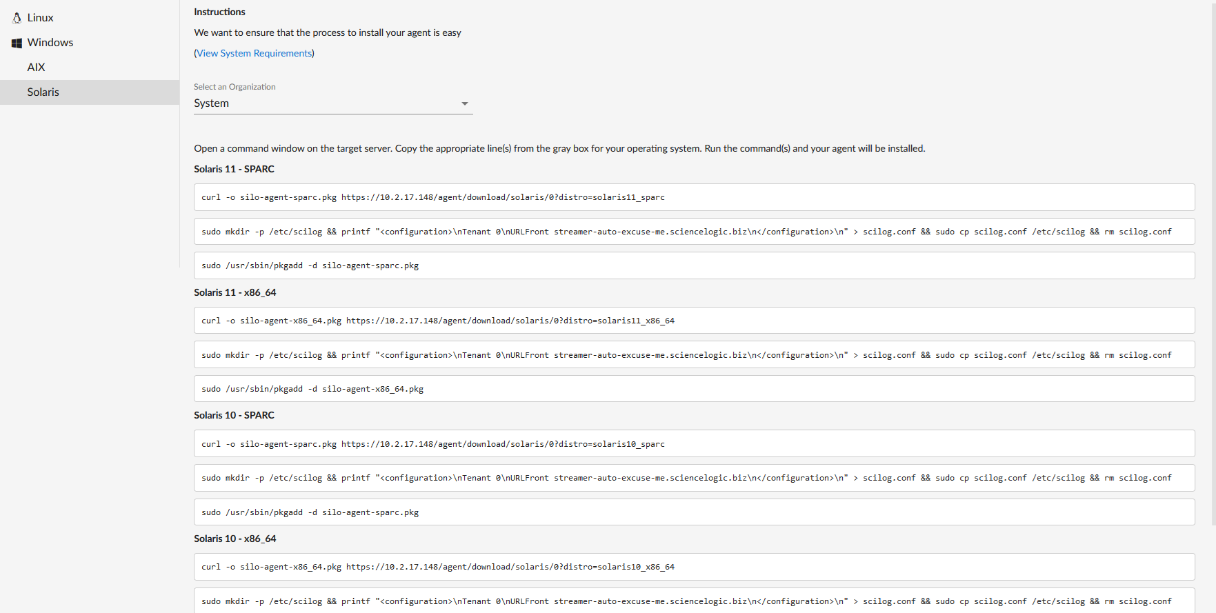

Installing a Solaris Agent
Beginning with Solaris agent version 184, by defaul the agent will install and run as a dedicated non-root system user named "scilog". To run the Solaris agent as root, add the file /etc/scilog/run_state.txt containing RUN_AS_ROOT=1.
For a Solaris system, the Agents page provides version-specific commands that will need to run on the Solaris system you want to monitor. This page includes commands for the following versions:
  • Solaris 11 - SPARC
  • Solaris 11 - x86_64
  • Solaris 10 - SPARC
  • Solaris 10 - x86_64
Solaris agent version 196 is the minimum version required for Skylar One 12.5.1.
To download and install a Solaris agent:
  1. On the Agents page (Devices > Agents), click the New Agent button. The Agent Installation page appears.
  1. Click the Solaris tab:
    Image of the Install a Solaris Agent page
  2. From the Select an Organization drop-down list, select an organization for the device on which you are installing the agent. The Tenant value in the commands on this page is updated with the Skylar One Organization ID for the organization you selected.
  3. Based on the version of Solaris running on the device you want to monitor, run the relevant commands from the Solaris tab on the Solaris device (the "target server"). After the commands complete, the Solaris agent starts running in the background. The device on which you installed the agent appears on the Agents page (Devices > Agents), and the device is also added to the list of devices on the Devices page.
You can also install the Solaris agent via the command line by executing the following commands:
mkdir -p /etc/scilog && printf "<configuration>\nTenant <organization_id> \nURLFront <streamer_URL>\n<configuration>\n" > scilog.conf && sudo cp scilog.conf /etc/scilog && rm scilog.conf
sudo pkgadd -d silo-agent.pkg
  • The file /etc/scilog/scilog.conf with fields TENANT and URLFRONT are required. Note that "<configuration>" is a valid component of the file content and not meant to be substituted with any company or organizational value.
  • The RUN_AS state can be set by adding file /etc/scilog/run_state.txt with RUN_AS_ROOT=<0|1>.
  • The default RUN_AS state is "scilog" when a /etc/scilog/run_state.txt file doesn't exist.

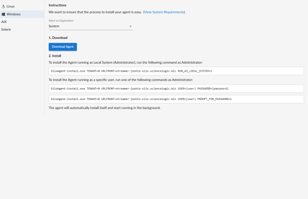

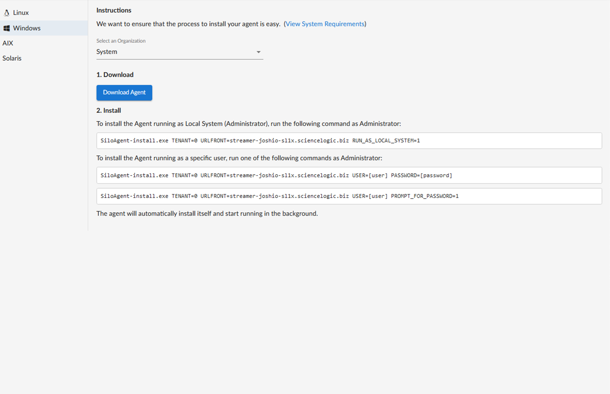

Installing a Windows Agent
For a Windows system, the Agents page provides an executable file (.exe) that you will need to run on the Windows system you want to monitor.
ScienceLogic provides an executable (.exe) installer called SiloAgent-install.exe. You will need to install and run the SiloAgent-install.exe file on the Windows system you want to monitor.
ScienceLogic also provides an MSI (.msi) installer upon request. The .exe installer is essentially a wrapper around the .msi file that allows for additional checks before installation, unwraps and runs the .msi file, prints information to the terminal, and provides information about failed installations. ScienceLogic recommends you use the .exe installer except for special cases. You can ask your ScienceLogic contact for an .msi file, if needed.
Skylar One supports the use of proxy server connections when using the Skylar One agent on Windows systems. For more information about installing and configuring a Windows agent with a proxy server, see Configuring the Windows Agent to Use a Proxy.
Windows agent version 154 is the minimum required version for Skylar One 12.5.1
To download and install a Windows agent in Skylar One:
  2. Click the Windows tab at top left:
    Image of the Install a Windows Agent page
  3. From the Select an Organization drop-down list, select an organization for the new agent. The Tenant value in the command on this page is updated with the Skylar One Organization ID for the organization you selected.
  4. Click Download Agent. An Opening SiloAgent-install.exe dialog appears.
  5. Save the SiloAgent-install .exe file for installing the agent.
  6. Copy the SiloAgent-install file you downloaded to the Windows system on which you want to run the agent. To do so, you can either go to the console of the Windows system or use a utility like WinSCP.
  7. To install the agent, use Windows PowerShell as an Administrator to run the command on the Windows system (the command is listed in step 2 on the Windows tab on the Agents page):
    .\SiloAgent-install.exe tenant=<organization_id> urlfront=<streamer_URL> RUN_AS_LOCAL_SYSTEM=1
    or
    .\SiloAgent-install.exe tenant=<organization_id> urlfront=<streamer_URL> USER=<user> PASSWORD=<password>
    where <organization_id> is Organization ID for the organization you selected in step 3, and <streamer_URL> is the URL for the Streamer service you are using as part of the Skylar One Extended Architecture.
    For example:
    .\SiloAgent-install.exe tenant=1 urlfront=streamer2020.int.sciencelogic.com RUN_AS_LOCAL_SYSTEM=1
    RUN_AS_LOCAL_SYSTEM=1 indicates the agent service will run with administrator privileges. USER and PASSWORD designate a dedicated user to run the service. See Configuring the Windows Agent for more information.
  8. When the agent installation completes, the PowerShell window displays "info: install complete", and the Windows agent starts running in the background. The device on which you installed the agent appears on the Agents page (Devices > Agents), and the device is also added to the list of devices on the Devices page.
  9. To verify that the installation was successful, open the Windows Task Manager or enter the TASKLIST command to view running processes. The SiloAgent process will be running on the Windows machine.
When you upgrade to a newer version of the Windows agent, the installer upgrades the agent without generating a new CollectorID. The previous version's configuration file is passed to the upgraded version of the agent. The upgraded Windows agent continues to upload data to the same device record in Skylar One.

SiloAgent-install.exe TENANT=0 URLFRONT=10.1.1.2 RUN_AS_LOCAL_SYSTEM=1
  1. Tenant and URLFront values must be specified.
    • TENANT. Corresponds to Organization ID in Skylar One. TENANT is required for agent installation. The Windows agent will continue to use the same Tenant value during an upgrade.
    • URLFRONT. The URL or IP for the streamer service. URLFRONT is required for Agent Installation. The Windows agent will continue to use the same URLFront value during an upgrade.
  2. RUN_AS_LOCAL_SYSTEM=1 must be specified.
When installing the agent for the first time on a device running as a dedicated user named "scilogrunner" (local account on the device) with a password "qwerty".
SiloAgent-install.exe TENANT=0 URLFRONT=10.1.1.2 RUN_AS_USER=1 USER=scilogrunner PASSWORD=qwerty
When installing the agent for the first time on a device running as a dedicated user named "MYDOMAIN\scilogrunner" (domain account) on "MYDOMAIN" with password "qwerty".
SiloAgent-install.exe TENANT=0 URLFRONT=10.1.1.2 RUN_AS_USER=1 USER=MYDOMAIN\scilogrunner PASSWORD=qwerty
When installing the agent for the first time on a device running as a dedicated local user named "scilogrunner" with the password "qwerty", and granting the suer the "Log on as a service" user right, the "Debug programs" user right and adding the user to the "Performance Monitor Users" group.
SiloAgent-install.exe TENANT=0 URLFRONT=10.1.1.2 RUN_AS_USER=1 USER=scilogrunner PASSWORD=qwerty LOG_ON_AS_A_SERVICE=1 DEBUG_PROGRAMS=1 PERFORMANCE_MONITOR_USERS=1
  1. Grant the user the "Log on as a service" and "Debug programs" user rights.
  2. Add to the Performance Monitor Users group.

Linux Installation Commands-Debian and Ubuntu (Example)
. To authenticate the Linux agent for Debian and Ubuntu, follow the example on GQL mutations and how to acquire AGENT_GUID and AGENT_TOKEN with GQL. For more information about installation, see Installing a Linux Agent.
New agent installation with AP2_USER and AP2_PASSWORD
sudo TENANT=0 URLFRONT=url RUN_AS_ROOT=1 AP2_USER=em7admin AP2_PASSWORD=em7admin dpkg -i sl_agent.rpm
New agent installation with AGENT_GUID and AGENT_TOKEN
sudo TENANT=0 URLFRONT=url RUN_AS_ROOT=1 AGENT_GUID=xxx AGENT_TOKEN=yyy dpkg -i sl_agent.rpm
Upgrading an agent without a token to Linux version 189 or later and acquiring a tokeN with AP2_USER and AP2_PASSWORD
sudo AP2_USER=em7admin AP2_PASSWORD=em7admin dpkg -i sl_agent.rpm
Upgrade an agent without a token to Linux version 189 or later and acquiring a token with AGENT_GUID and AGENT_TOKEN
sudo AGENT_GUID=<existing CollectorID> AGENT_TOKEN=<acquired token> dpkg -i sl_agent.rpm
Linux Installation Commands-RHEL, CentOs, and AIX (Example)
To authenticate the Linux agent for RHEL and CentOs, follow the example on GQL mutations and how to acquire AGENT_GUID and AGENT_TOKEN with GQL. For more information about Linux installation, see Installing a Linux Agent. For more information about AIX installation, see Installing an AIX Agent.
sudo TENANT=0 URLFRONT=url RUN_AS_ROOT=1 AP2_USER=em7admin AP2_PASSWORD=em7admin rpm -ivh sl_agent.rpm
sudo TENANT=0 URLFRONT=url RUN_AS_ROOT=1 AGENT_GUID=xxx AGENT_TOKEN=yyy rpm -ivh sl_agent.rpm
sudo AP2_USER=em7admin AP2_PASSWORD=em7admin rpm -U sl_agent.rpm
sudo AGENT_GUID=<existing CollectorID> AGENT_TOKEN=<acquired token> rpm -U sl_agent.rpm

Configuring a Linux Agent to Use a Proxy
In the scilog_proxy.conf file, you can specify up to four Linux proxy server configurations when installing the agent. If the connection through the primary proxy fails or the proxy is unavailable, the agent will attempt to make the connection through the other specified proxies.
In version 12.3.6 and earlier, you can configure only one proxy server when installing the agent.
To configure the Linux agent to use a proxy server connection:
  1. Create a configuration file named scilog_proxy.conf and add the following proxy information to the new file:
    Proxy-Server
    Proxy-Port

aix
sudo TENANT=0 URLFRONT=10.1.1.2 proxyserver=10.2.1.1 proxyport=3128 proxyusername=1 proxypassword=1 rpm -Uvh scilogd-0.173.17-0.aix7.2.noarch.rpm

Upgrading an Agent
When you have the latest version of the Skylar One agent, a check mark icon () appears in the Newest Version column for that agent. If you do no have the latest version of the agent, an Upgrade button appears in the Newest Version column on the Agents page.
To upgrade to the latest version of an agent:
  1. On the Agents page (Devices > Agents), locate the agent you want to upgrade:
    Image of the Agents page with an Upgrade button
  2. Click the Upgrade button for that agent. The agent starts the upgrade process, which might take up to a minute to complete.
  3. Click the Refresh button in your browser to ensure that a check mark icon () appears in the Newest Version column for that agent.
It is not possible to configure the service USER when upgrading through the Skylar One user interface as the agent will continue using the service that USER already uses.

Stopping an Agent
You can use the "delete" option on the Agents page to stop an agent from running. When you delete an agent, Skylar One stops the agent from running on the device, deletes the data gathered by that agent, and removes that agent from the Agents page.
Using the "delete" option for an agent does not actually remove the agent from the device. As a best practice, use the delete process to delete the data gathered by the agent (the uninstallation process does not delete this data), and then uninstall that agent, if needed. For uninstallation details, see Uninstalling an Agent. Also, ScienceLogic recommends that you delete the device that had the agent installed on it, or at least remove the agent-related Dynamic Applications, to prevent Skylar One from attempting to use the data the agent gathered from that device.
To delete an agent and its data:
  1. On the Agents page (Devices > Agents), locate the agent you want to delete.
  2. Click the actions icon (image of actions icon) for that agent and select Delete. Skylar One stops the agent from collecting data.
You can also delete an agent from Skylar One using the Device Manager page (Devices > Classic Devices, or Registry > Devices > Device Manager in the classic user interface). Click the checkbox for the device with the agent and select Delete Selected Devices from the Select Action menu at the bottom of the page.

Uninstalling an AIX Agent
To uninstall an agent on an AIX system:
  1. Log in to the AIX system via the console or SSH as a user that has sudo administrator permissions.
  2. To determine which package version is currently running, execute the following command:
    sudo rpm –ga|grep -i scilogd
    To determine which package version is running from a previous command, execute the following command:
    sudo rpm –e
  3. Optionally, you can remove the agent configuration directory from the Linux system. The configuration directory can be found at:
    /etc/scilog (rm -rf /etc/scilog)
Uninstalling a Solaris Agent
To uninstall an agent on a Solaris system:
  1. Log in to the Solaris system via the console or SSH as a user that has sudo administrator permissions.
  2. To uninstall the agent, execute the following command:
    sudo pkgrm scilogd

Installing an Agent from the Devices Page or the Device Manager Page
If you are using a distributed Skylar One system without the Skylar One Extended Architecture (which includes Compute Nodes, Storage Nodes, and a Management Node), you must install the agent from the Devices page or from the Device Manager page (Devices > Classic Devices, or Registry > Devices > Device Manager in the classic user interface).
TCP port 443 must be open between the Message Collector and the device on which an agent is installed.
If you are using a Skylar One system with the Skylar One Extended Architecture, you must use the Agents page (Devices > Agents) to install agents, including AIX and Solaris agents. AIX and Solaris agents are not available if you do not use the Skylar One Extended Architecture.
If you are not using the Skylar One Extended Architecture, the Agents page (Devices > Agents) does not appear in the Skylar One user interface.
When you install an agent from the Devices page or from the Device Manager page, you receive different content based on which type of agent you are installing:
  • For a Linux system, the page displays commands that you must run on that system.
  • For a Windows system, the page provides an executable file to run on the Windows system.
To gather the necessary commands and executable files to install an agent on a device:
  1. Do one of the following:
    • Go to the Devices page. Click the down arrow next to the Add Devices button and select Download/Install Agent. The Download/Install Agent modal appears.
    • Go to the Device Manager page (Devices > Classic Devices, or Registry > Devices > Device Manager in the classic user interface), then click Actions and select Download/Install Agent. The Agent Installation modal appears.
  2. On the modal, complete the following fields:
  • Select an OS. Select the operating system running on the device on which you want to install the agent.
  • If you require a Federal Information Processing Standards (FIPS)-compliant version of the Skylar One agent, select RedHat/CentOS 64-bit (OS Libs).
  • Select an Organization. Select an organization. The list of organizations is dependent on your user account. If the agent discovers a new device, that device belongs to the organization you select here.
  • If you are installing an agent on a device that has already been discovered, you must select the organization that is already aligned with the existing device.
  • Select a Message Collector. Select the Message Collector to which the agent sends its collected data.
  1. If you select a Linux operating system in the Select an OS field, the modal displays a list of commands to execute on the Linux system. Copy the commands for use during the installation on the Linux device.
  2. If you select a Windows operating system in the Select an OS field, the modal displays a Download Windows Agent link. Click the link and save the executable file for use during the installation on the Windows device.
If you are installing an agent on multiple devices that run the same operating system, are part of the same organization, and connect to the same Message Collector, you can reuse the same commands or executable file on each of those devices.
Installing an Agent on a Linux System
To install an agent on a Linux system:
Copy and execute the appropriate commands from the Agent Installation page to download and install the agent. For more information on install commands, see Installing a Linux agent.
Skylar One supports the use of proxy server connections when using the Skylar One agent on Linux systems. To do so, open a command window on the target server and first configure curl to use a proxy server using the CURLOPT_PROXY option, and then to use a username and password combination for that proxy server using the CURLOPT_PROXYUSERPWD option.

Installing an Agent on a Windows System
To install an agent on a Windows system:
  1. Copy the SiloAgent-install.exe file you downloaded from the Agent Installation page to the Windows system.
  2. Execute the appropriate command copied from the Agent Installation page to install the agent. For more details about install commands see Installing a Windows Agent.
Skylar One supports the use of proxy server connections when using the Skylar One agent on Windows systems. In Windows 10, go to Settings > Network & Internet > Proxy to set up a proxy; in older versions of Windows, you can do this by clicking on the Control Panel and going to Internet Options > Connections > LAN Settings. If a proxy server requires authentication, you will need to provide a username and password before traffic is allowed through the proxy server and to the Internet.

Installing SiloAgent-install.exe on RSTLSW12T16EX01
Executing C:\temp\foo\SiloAgent-install.exe Tenant=0 URLFront=streamer-shared-e2e-testing.int.sciencelogic.com
Deleting C:\temp\foo
SiloAgent-install.exe installed successfully.
100% Success installing SiloAgent-install.exe on 2 of 2 computers:
rstlsw12t16ls01 rstlsw12t16ex01
