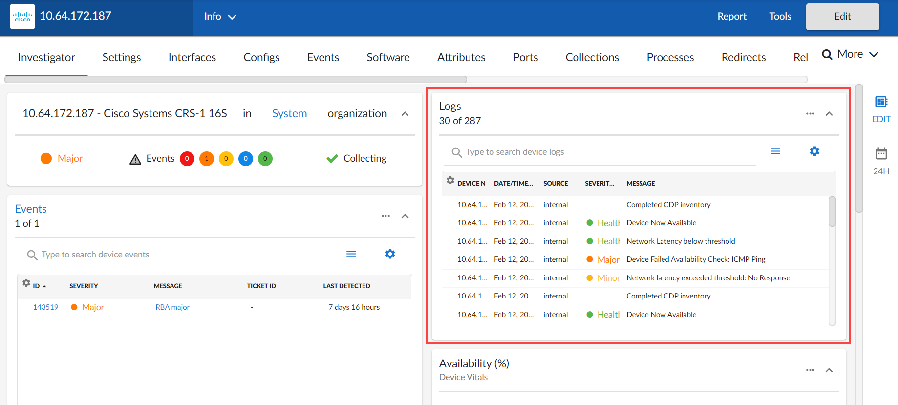

You can view logs and messages for a device in the Investigator tab of the Device Investigator page.
The Investigator tab displays a customizable set of metrics and panels that display information about the selected device. One of those panels is the Logs panel:
Image of the Logs panel in the Device Investigator
The Logs panel displays all of the messages Skylar One and the Skylar One Agent, if applicable, have collected from the device. You might find it helpful to view these log entries during troubleshooting or to manually check on the status of a device.
NOTE: For more information about Log File Monitoring Policies and using the Skylar One Agent to monitor device logs, see the section on Monitoring Logs Using the Skylar One Agent.
The Logs panel displays the following information about each device log entry:
  • Device Name. The name of the device on which the log message was collected.
  • Date/Time. The date and time the entry was made in the log.
  • Source. The entity or process that generated the message. Options include:
  • Syslog. Entry was generated from standard system log generated by device.
  • Internal. Entry was generated by Skylar One.
  • Trap. Entry was generated by an SNMP trap.
  • Dynamic. Entry was generated by a Dynamic Application.
  • API. Entry was generated by another application.
  • Email. Entry was generated by an email message from a third-party application to Skylar One.
  • ScienceLogic Agent. Entry was generated by the Skylar One Agent.
  • Severity. The color-coded severity of the event that generated the log entry, if applicable. Possible values are:
  • Critical. Indicates a condition that can seriously impair or curtail service and requires immediate attention (for example, service or system outages).
  • Major. Indicates a condition that impacts service and requires immediate investigation.
  • Minor. Indicates a condition that does not currently impair service, but the condition needs to be corrected before it becomes more severe.
  • Notice. Indicates a condition that does not affect service but about which users should be aware.
  • Healthy. Indicate that a device or condition has returned to a healthy state. Frequently, a healthy event is generated after a problem has been fixed.
  • Message. Text of the log entry. If the system has collected the same message multiple times, the log indicates how many times the message has repeated.
