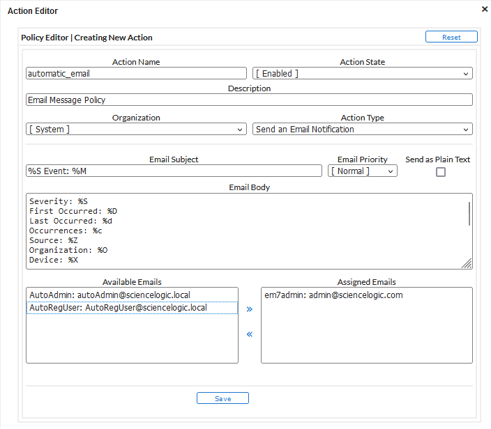

In this example, you will need to first create the action policy for sending the email.
The example action policy called "automatic_email" looks like this:
  • We specified that this action policy:
  • Is enabled.
  • Will act upon events and devices aligned with the System organization.
  • Will send an email notification in response to an automation policy.
  • Will include the default Email Subject and Email Body.
  • Will label email messages with Normal priority.
  • Will send an email message to admin@sciencelogic.com.

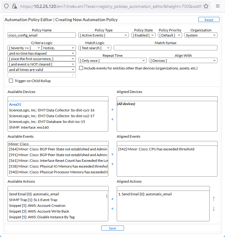

Automation Policy
For this example, our example automation policy might look like this:
  • We specified that the automation policy:
  • Should act upon active events.
  • Is enabled.
  • Is associated with the organization "System".
  • Will be triggered when the specified event has a severity equal to or greater than "Notice".
  • Will be triggered as soon as the specified event occurs.
  • The policy will trigger the action only once for each instance of the event.
  • Will be triggered at any time.
  • Will be triggered when the selected event occurs on at least one of the selected Cisco devices.
  • Will be triggered when the event "Cisco: CPU has exceeded threshold" occurs on at least one of the selected Cisco devices.
  • We specified that when all the criteria in the automation policy are met, the action policy "automatic_email" will be executed.

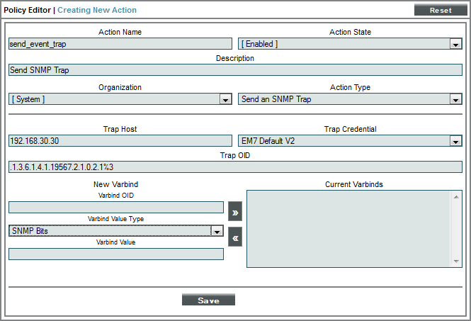

Action Policy
The action policy called "send_event_trap" looks like this:
  • Is enabled.
  • Will send an SNMP trap in response to an automation policy.
  • Will send the trap to the trap host at 192.168.30.30.
  • Will use the credential "EM7 Default V2" to send the trap to the trap host at 192.168.30.30.
  • Will send an event type-based trap, using the OID .1.3.6.1.4.1.19567.2.1.0.2.1.event_policy_ID. We use the variable %3, so that EM7 will append the current event's policy ID to the trap OID. (The current event will be the event that triggered the action policy. This event is specified in the automation policy.)
  • Includes all the EM7 varbinds in the trap.
Sent Trap
Suppose the criteria in our automation policy "cisco_config_send_trap" was met and that the trigger event "Cisco: ConfigManEvent" occurred on the device "CustB_2821-1.cisco.com".
Suppose our action policy "send_event_trap" was successfully triggered and executed.
Our action policy will build and send an event trap like this:

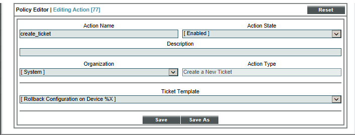

Action Policy
The action policy called "create_ticket" looks like this:
  • Is enabled.
  • Will create a new ticket in response to an automation policy.
  • Will use the ticket template "Rollback Configuration on Device %X" to create the ticket.

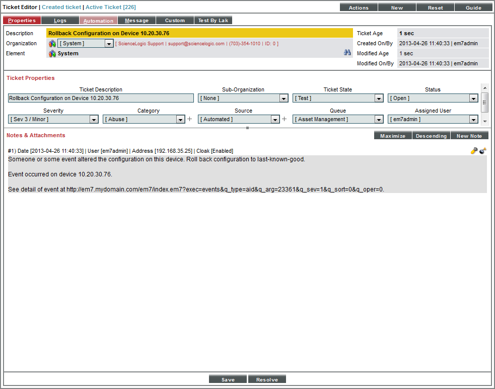

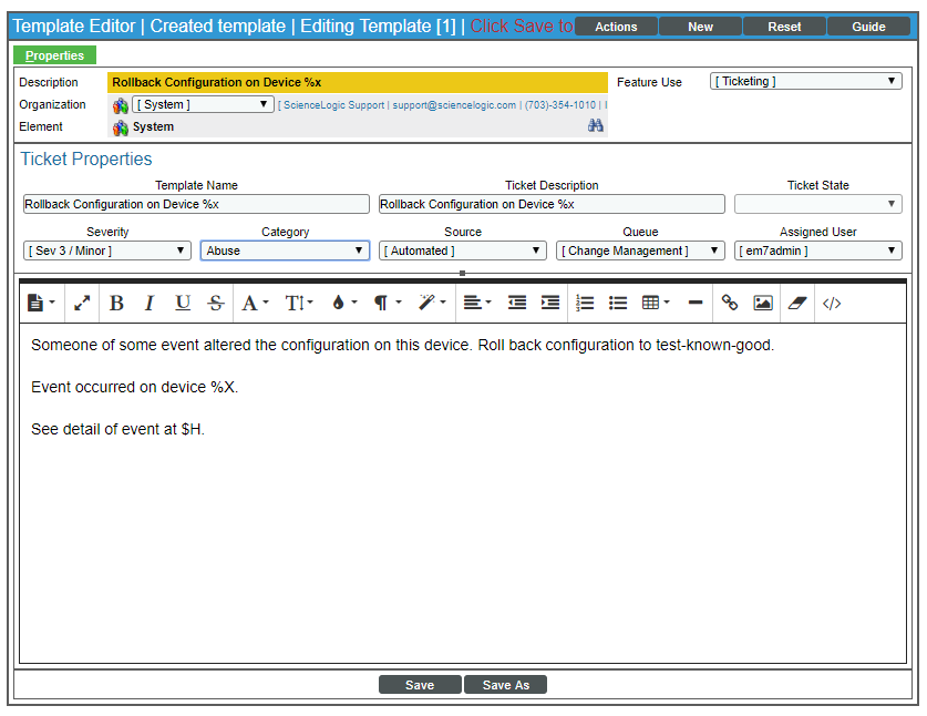

Ticket Template
The Ticket Template "Rollback Configuration on Device %X" looks like this:
  • We specified that the ticket template :
  • Will create a ticket that includes the name of the affected device in the description.
  • Will create a ticket that is associated with the organization "System".
  • Will create a ticket that has a severity of "Minor".
  • Will create a ticket that will be placed in the "Monitoring" ticket queue.
  • Will create a ticket that will be assigned to the user "em7admin".
  • Will create a ticket that will have a category of "Abuse".
  • Will create a ticket that will have a source of "Automation".
  • Will appear as a choice in action policies.
  • Will create a ticket that includes note text that reads:
Someone or some event altered the configuration on this device.  Roll back configuration to last-known-good.
Event occurred on device device_name.
See detail of event at link for event.
Resulting Ticket
Suppose that the trigger event "UPS Battery Capacity has Degraded Below Threshold" occurred on the device "10.20.30.76".
Our action policy will build a ticket like this:

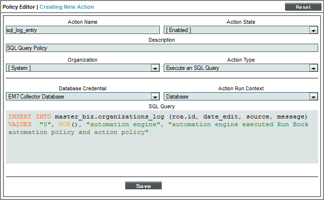

Action Policy that Sends an SQL Query to an External Server
Suppose you want to create a custom Quick Report that displays the number of automation policies that are executed and the date and time each execute occurs. However, by default, Skylar One does not log this information to the system logs or access logs.
To solve this problem, you could create an SQL action that automatically creates a log entry in the audit logs in the database each time an automation policy is executed. You could then include this action in each automation policy, so that Skylar One automatically creates a log entry in the database each time an automation policy is executed.
You could later write a custom Quick Report to retrieve, format, and display the log entries from the database.

Action Policy
The action policy called "sql_log_entry" looks like this:
  • is enabled.
  • will act upon events and devices aligned with the System organization.
  • will execute an SQL query.
  • will use the credential "MySQLWrite" to connect to the database.
  • will add a new row of data to the table organizations_log in the database master_biz, using following MySQL INSERT command:
INSERT INTO master_biz.organizations_log
(roa.id, date_edit, source, message)
VALUES ("0", NOW(), "automation engine", "automation engine executed Run Book automation policy and action policy")

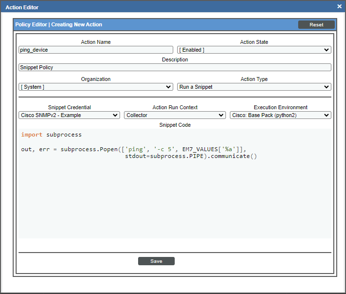

Action Policy that Executes a Snippet and Triggers a New Alert
Skylar One includes a sample action policy that executes a Snippet. This example Snippet pings a device, stores the results in a variable, and makes an entry in a ScienceLogic database table. Skylar One will check the entries in this database table and try to match the messages to an existing event policy.

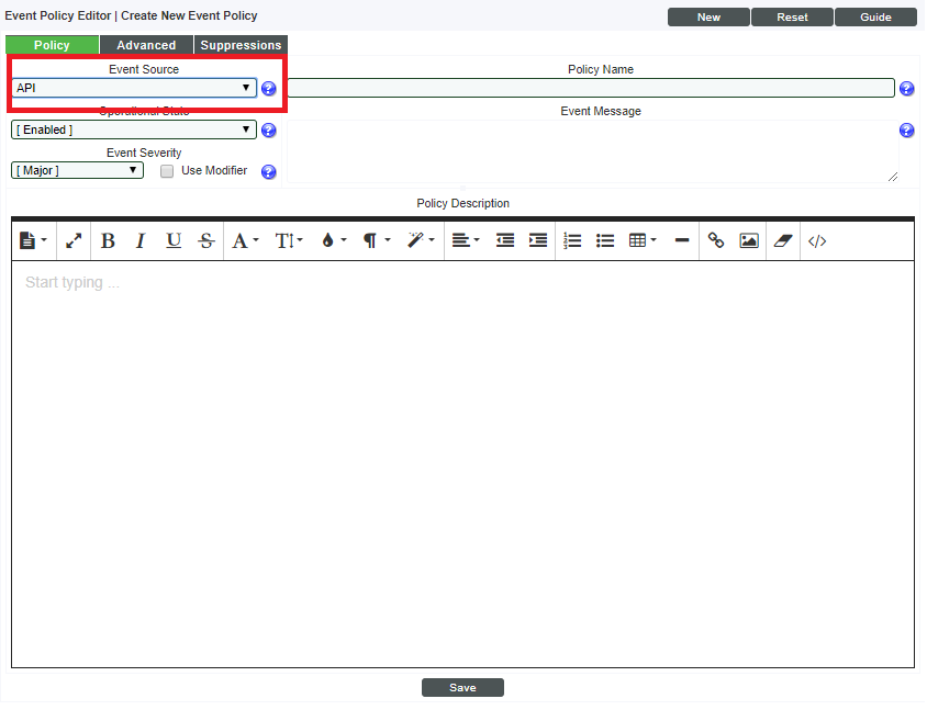

NOTE: To use this example action policy to trigger an event, you must define an event policy with an Event Source of API and a First Match String value that will match against the value in the Message column in the database in_api, in the table messages. When a new entry is made to the database in_api, in the table messages, this triggers Skylar One to check the value in the Message column against any existing event policies.
The code for the Snippet looks like this (line numbers were added for easy reference and are not included in the code):
1) import MySQLdb
2) import subprocess
3) CDB_IP = '192.168.9.90'
4) out, err = subprocess.Popen(['ping', '-c 5', EM7_VALUES['%a']], stdout=subprocess.PIPE, stderr=subprocess.PIPE).communicate()
5) EM7_RESULT = out
6) if ' 0% packet loss' not in out:
7) conn = MySQLdb.connect(user='root', passwd='<password>', host=CDB_IP, port=7706)
8) cur = conn.cursor()
9) cur.execute("""INSERT INTO 'in_api'.'messages' ('xtype', 'xid', 'message', 'value', 'message_time') VALUES (%s, %s, %s, '', NOW())""", (EM7_VALUES['%1'], EM7_VALUES['%x'], 'Bad connection to %s' % EM7_VALUES['%a']))
10) cur.execute("""COMMIT""")
The code performs the following:
  • Line 1. Tells the code to use the code in the MySQLdb module. This module allows the code to connect to a MySQL database and execute SQL commands.
  • Line 2. Tells the code to use the subprocess module to spawn processes, access stdin and stout for those processes, and retrieve return codes for those processes.
  • Line 3. Defines the variable CDB_IP, the IP address of the Database Server (to use this example, supply the IP address of the Database Server in your network).
  • Line 4. Uses the subprocess module to run the ping command.
  • Notice that the argument for the ping command is EM7_VALUES['%a']. EM7_VALUES is the global dict that allows a Snippet to access the substitution variables. The substitution variable %a contains the IP address for the device where the event occurred.
  • Notice that the results are stored in the variable out.
  • Line 5. Stores the value of the variable out in the global Snippet variable EM7_RESULT. The global Snippet variable EM7_RESULT is used to populate the variable %_EM7_RESULT_%. The value of the variable %_EM7_RESULT_% can be accessed by the next Action Policy.
  • Line 6. Defines the criteria for triggering a new event. The code says "If the variable out does not contain the value '0% packet loss' perform the following lines of code. If the variable out does contain the value '0% packet loss' do not perform the following lines of code."
NOTE: The following lines will enter a row into the database in_api, in the table messages. This table allows external APIs to trigger an event. When a new entry is made in this database table, it triggers Skylar One to try to match the value in the Message column with an existing event policy.
  • Line 7. Uses the MySQLdb module and the connect method to connect to the Database. The connect method passes the user ID, password, IP address of the Database Server, and the port to use to connect to the database.
In the connect method, use the same username and password you would use to connect to the Database through the PHPMyAdmin interface, from the Appliance Manager page (System > Settings > Appliances).
  • Line 8. Uses the cursor method to create a cursor object for processing SQL statements.
  • Line 9. Uses the execute method to execute an SQL statement. In this case, the SQL statement says:
  • Perform an INSERT in the database in_api, in the table messages.
  • Insert values into the following columns: xtype, xid, message, value, message time.

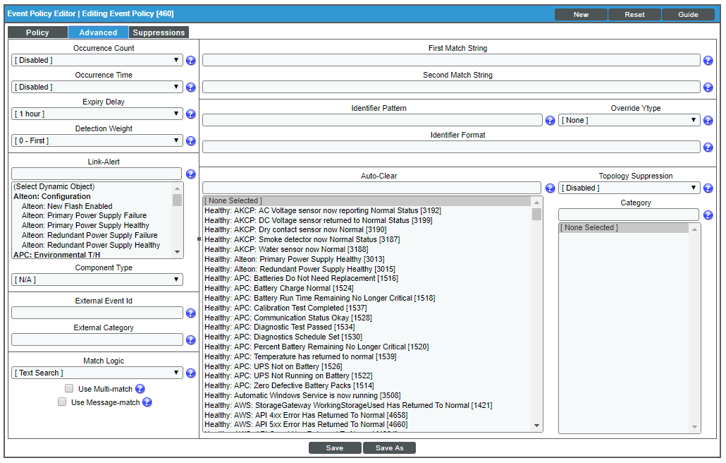

To define an event policy based on the alert (database entry) generated by this Snippet, you would perform the following:
  1. Navigate to the Event Policy Manager page. (Events > Event Policies)
  2. In the Event Policy Manager page, click the Create button.
  3. The Event Policy Editor page is displayed.
  4. In the Event Policy Editor page, in the Policy tab, provide the following values:
  • Event Source. Select API. This tells Skylar One to look for new entries in the in_api.messages table.
  1. In the Event Policy Editor page, in the Advanced tab, provide the following values:
  • First Match String. Enter a search string that matches the text we entered into the message column of the database table. In this case, we would enter "Bad connection to".
  • In the Match Logic field, we also selected Text Search, to tell Skylar One to search for the text string we entered in the First Match String field, and not a regular expression.
  1. For additional details on the Event Policy Editor page and tabs and creating event policies, see the manual Events.
  2. Click the Save button to save your new event.
  3. The event will be triggered each time a new entry is made to the database in_api, in the table messages, that contains the text "Bad connection to".

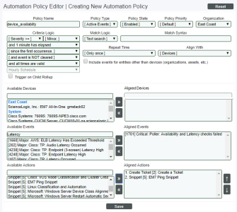

Automation Policy
Our automation policy would look like this:
  • Is enabled.
  • Will be triggered when the specified event has a severity equal to or greater than "Minor".
  • Will be triggered 1 minute after the event occurs and is not cleared.
  • The policy will trigger the action policies once for each occurrence of the event(s).
  • Will be triggered when the selected event occurs on at least one of the selected devices.
  • Will be triggered when the event "Critical Poller: Availability and Latency checks failed" occurs on at least one of the selected devices (which in this case is all devices).
  • We specified that when all the criteria in the automation policy are met, the action policy "ping_device" and then the action policy "Create Ticket: Create Ping Ticket" will be executed, in the order specified.
Snippet Action Policy
The Snippet Action Policy would look like this:
The Execution Environment field's drop-down list displays the specific Python version of each execution environment.
This action policy:
  • Tells the code to use the subprocess module to spawn processes, access stdin and stout for those processes, and retrieve return codes for those processes.
  • Uses the subprocess module to run the ping command.
  • Notice that the argument for the ping command is EM7_VALUES['%a']. EM7_VALUES is the global dictionary that allows a Snippet to access the substitution variables. The substitution variable %a contains the IP address for the device where the event occurred.
  • The value of the variable out is stored in the global Snippet variable EM7_RESULT. The global Snippet variable EM7_RESULT is used to populate the variable %_EM7_RESULT_%. The value of the variable %_EM7_RESULT_% can be accessed by the next Action Policy.
Ticket Action Policy
The Ticket Action Policy would look like this:

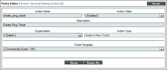

  • Is enabled.
  • Will use the ticket template "Connectivity Event: %M" to create the ticket.

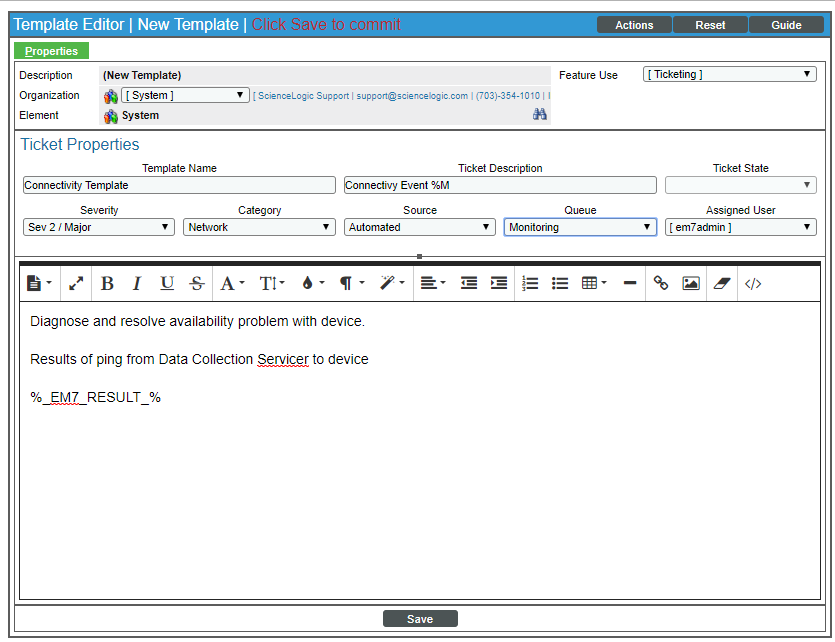

Ticket Template
The Ticket Templates specified in the Create Ticket Action Policy would look like this:
  • We specified that the ticket template:
  • Will create a ticket that includes the event description (%M) in the description.
  • Will create a ticket that has a severity of "Major".
  • Will create a ticket with the category "Network".
  • Will create a ticket with the source "Automated".
Diagnose and resolve availability problem with device.
Results of ping from Data Collection Server to device:
%_EM7_RESULT_%
Where the variable %_EM7_RESULT_% will contain the results from the previous Snippet Action Policy. In this case, the variable %_EM7_RESULT_% will contain the results from a ping from the Data Collector to the device where the availability event occurred.

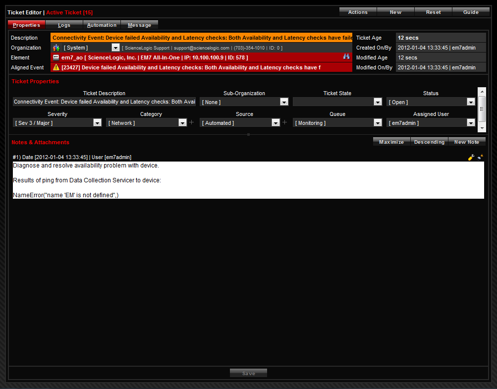

Resulting Ticket
The resulting ticket would look like this:
