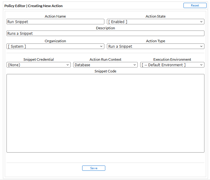

This section describes how to create an action policy that executes a snippet, which is a custom-written Python program.
Creating an Action Policy that Executes a Snippet
In the Action Policy Editor page, if you selected the Action Type of Run a Snippet, the new action policy will execute a custom-written Python program. If the action policy is aligned with an automation policy (i.e., if the action policy is included in the definition of an automation policy), and the criteria in the automation policy are met, Skylar One will execute the Snippet. Snippet action policies can only include object types that can be serialized and deserialized by JSON data formats.
For increased flexibility and connectivity, you can specify whether the Snippet should be executed by the Database Server or by the Data Collector. In some cases, a device might not accept connections from the Database Server or may not be "visible" from the Database Server. In these situations, you can specify that the Snippet be executed by the Data Collector.
NOTE: For Skylar One systems that are using an All-In-One Appliance, you cannot choose to execute a policy on a Database Server or a Data Collector. All policies will be executed on the All-In-One Appliance.
An action policy that executes a Snippet is useful when you want to run detailed network diagnostics on a device. For example, if Skylar One generates an event saying that a device is not responding to ping, you could run a Snippet that performs a traceroute and specify that Skylar One execute the Snippet from the Data Collector server. You would then execute a traceroute from the Data Collector to the device, store the results in the variable %_ EM7_ RESULT_%, and use that variable to pass the results to another action policy.
An action policy that executes a Snippet is useful when you want to perform some automated steps on the device to resolve a problem. For example, when a specific event is triggered, you could run a Snippet that turns on debugging on the remote device and copies the logs to another remote device.
NOTE: Snippets are developed using the Python programming language. To create a Snippet Action Policy, you must be familiar with the programming techniques and data structures of the Python language.
In the Action Policy Editor page, if you select the Action Type of Run a Snippet, you must supply values in the fields specified in Action Policies and also in the following fields:
  • Snippet Credential. Credential that allows Skylar One to execute the Snippet code on the external device. Usually, these are credentials of type "Basic". The list of credentials is filtered to include only those credentials to which you have access.
If this field has already been set to a credential to which you do not have access, this field will display the value Restricted Credential. If you set this field to a different credential, the entry for Restricted Credential will be removed from the list in this field; you will not be able to re-align the device with the Restricted Credential.
NOTE: Your organization membership(s) might affect the list of credentials you can see in the Snippet Credential field.
  • Action Run Context. This option is not available on All-In-One Appliances. Specifies whether the action will be executed on the Database Server or on the Data Collector. The Choices are:
  • Database. Execute the action from the Database Server.
  • Collector. Execute the action from the Data Collector associated with the device. This is useful when a device doesn't accept connections from the Database Server or may not be "visible" from the Database Server.
  • Execution Environment. Select the execution environment to which you want to align the action. An execution environment is an on-demand Python environment that contains the supporting modules, code, scripts, directories, and files (packaged in ScienceLogic Libraries) for the snippet. An execution environment includes its own installation directories, doesn't share libraries with other environments, and allows granular control of dependencies, versions, and permissions. The default execution environment is System.This list also shows the Python version of each selectable execution environment. For more information, see the section on Managing Execution Environments.
  • Snippet Code. Python code for the Snippet.
