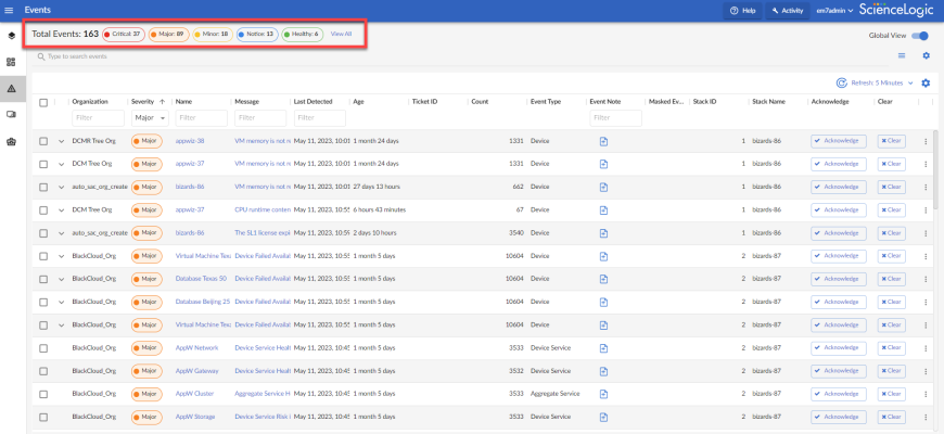

The Events page displays a list of active events, from critical to healthy. From this page you can acknowledge, clear, and view more information about an event. You can also view events by organization to focus only on the events that are relevant to you.
By default, the events listed on the Events page are sorted by severity, highest to lowest, and then secondarily sorted by the events' last occurrences, most recent to least recent. This ensures that the most severe and most recent events appear at the top of the page. If you prefer, you can change the sorting preferences and Skylar One will recall those changes the next time you return to the Events page.
To navigate to the Events page, click the Events icon ():
In a Global Manager system:
  • When the Global View button on the Events page is toggled on, you can view a list of events that have occurred across all of the stacks in your Global Manager system.
  • When the Global View button on the Events page is toggled off, you can view a list of events that have occurred only on the Global Manager system itself.
If you are looking for a specific set of events, click the gear icon () to the right of the Search field and select Advanced. In this mode, you can create an advanced search using "AND" or "OR" operators for multiple search criteria. For more information, see Performing an Advanced Search.
For each event, the Events page displays the following information:
  • Organization. The organization with which the event is associated. Click the organization hyperlink to view more information about the organization.
  • Severity. The severity of the event. Possible values are:
  • Critical. Indicates a condition that can seriously impair or curtail service and requires immediate attention (for example, service or system outages).
  • Major. Indicates a condition that impacts service and requires immediate investigation.
  • Minor. Indicates a condition that does not currently impair service but needs to be corrected before it becomes more severe.
  • Notice. Indicates a condition that does not affect service but about which users should be aware.
  • Healthy. Indicate that a device or condition has returned to a healthy state. Frequently, a healthy event is generated after a problem has been fixed.
Optionally, you can filter the list of events so that only events of a specific severity level appear on the Events page. For more information, see the section Filtering Events by Severity.
  • Name. The name of the entity associated with the event. Click the name hyperlink to view more information about the entity.
  • Message. The message generated for the event. Click the message hyperlink to go to the Event Investigator, where you can view more information about the event, including a description, the probable cause for the event, and possible resolutions, among other things.
You can also view the Event Investigator page by clicking the Actions button () for the event and selecting View Event.
  • Age . The number of days, hours, and minutes since the first occurrence of the event. This is also the time since the event occurred without the event having been cleared.
  • Count. The number of times the event has occurred or the number of child events associated with the event or the number of masked events associated with the event.
  • Event Note. Click the Note icon () to view any existing user-defined notes about the event or to create or edit a note about the event. When you do so, the Edit Event Note modal page appears, where you can create or edit a note and save your changes. For more information, see the section Viewing and Editing Event Notes.
You can also view, create, or edit event notes by clicking the Actions button () for the event and selecting Edit Event Note.
  • Masked Events. If the event has occurred multiple times on the same device that uses the event mask setting, click the masked events icon () in the Masked Events column for the relevant event open the Masked Events Overview modal, where you can view details about the masked events. For more information, see the section Filtering for Masked Events.
You can also view masked events on the Event Investigator page by clicking the Actions button () for the event and selecting View Event.
  • Automated Actions. The number of times the event has triggered the execution of an automation policy. If the event has triggered one or more automated actions, click the number hyperlink to go to the Event Actions Log, where you can view a log of all automated actions that have occurred for the event. For more information, see the section Viewing Automated Actions.
You can also view the Event Actions Log modal page by clicking the Actions button () for the event and selecting View Automation Actions.
  • Event ID. The unique ID for the event, generated by Skylar One. Click the ID hyperlink to go to the Event Investigator. In a Global Manager system, when the Global View button is toggled on, the event ID will be preceded by a number and an underscore, where the number preceding the underscore represents the stack on which the event occurred.
  • Event Source. The system or application that generated this event. Possible values are:
  • Syslog. The event was generated from a system log generated by a device.
  • Email. The event was generated by an email from an external agent. For example, Microsoft Operations Manager (MOM).
  • Internal. The event was generated by Skylar One.
  • Trap. The event was generated by an SNMP trap.
  • Dynamic. The event was generated by a Dynamic Application collecting data from the device.
  • API. The event was generated by a snippet Run Book Action, a snippet Dynamic Application, a request to the ScienceLogic API, or by an external system.
  • Skylar One agent. The event was generated by log file messages collected by the Skylar One agent. For more information about creating Log File Monitoring Policies to monitor log file messages collected by the agent, see the section on Monitoring Device Logs Using an Agent.
    Event Type. The type of entity associated with the event. Possible values are:
  • Organizations
  • Devices
  • Assets
  • IP networks
  • Interfaces
  • Business Service
  • IT Services
  • Device Services
  • Vendors
  • User Accounts
  • Virtual Interfaces
  • Last Detected. The date and time at which the event last occurred on the entity.
  • Ticket External Reference. The numeric ID associated with a ticket from an external ticketing system (that is, a ticket that was not created in Skylar One). Click the ticket reference value to view the external ticket in a new window.
NOTE: To link an external ticket to an event, you must create a custom Run Book Automation policy and a custom Run Book Action or use the ScienceLogic APIs. For more information, see the Configuring Global Manager for Event Ticketing section. For help with these tasks, contact ScienceLogic Customer Care.
  • Ticket ID. The ticket ID of the ticket that has been created for the event, if applicable.
  • Stack Name. The name of the stack on which the event occurred.
  • Stack ID. The numeric ID of the stack on which the event occurred.
  • Acknowledge. If the event has not been acknowledged, this column displays an Acknowledge button; click the button to acknowledge the event. If the event has been acknowledged, this column displays a check-mark character and specifies the user who acknowledged the event. For more information, see the section Acknowledging and Clearing Events.
  • Clear. Click the Clear button to clear the event. When you do so, the event is removed from the Events page. For more information, see the section Acknowledging and Clearing Events.
To rearrange the columns in the list, click and drag the column name to a new location. You can adjust the width of a column by clicking and dragging the right edge of the column. For more information about editing and adding columns, see Editing the Settings for an Inventory Page.

The Events page displays a list of currently active events, which can be sorted by any column, such as severity from critical to healthy. You can filter the list of events by severity by clicking one or more of the five colored buttons near the top of the Events page:
When you click a severity button, the list displays only events with the severity you selected. The severity button you clicked remains in color, while the other buttons turn gray.
To clear a severity filter, click the View All link next to the severity buttons.

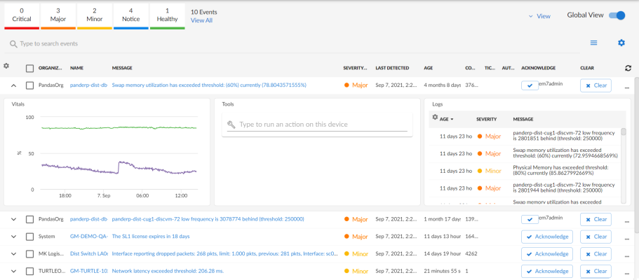

Viewing Additional Data about an Event
On the Events page, you can click the down-arrow icon () next to the name of an event to open a drop-down panel called the Event Drawer. The Event Drawer contains additional data about that event:
Image of the Event Drawer
NOTE: The Event Drawer displays only for events that are aligned with devices.
On the Event Drawer, you can access the following panes:
  • The Vitals pane displays graph data for the past 24 hours of CPU and memory usage for the device related to the event. You can zoom in on a shorter time frame by clicking and dragging your cursor over a timeframe, and you can go back to the original time span by clicking the Reset zoom button.
  • The Tools pane enables you to run a set of network diagnostic tools or user-initiated actions in the Activity Center. Click the search bar to search for a tool or action to run, or click one of the default tools or actions that are available based on the device type and your user permissions. For more information, see the section on Using the Action Runner.
  • The Logs pane displays a list of the log entries from the device's log file, sorted from newest to oldest by default.

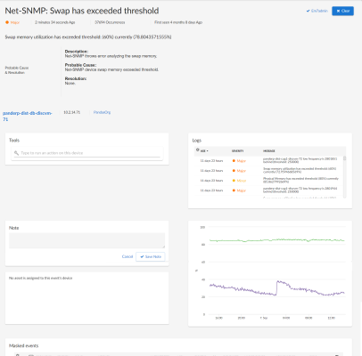

Using the Event Investigator
The Event Investigator page provides details about the event as well as the device associated with the event, where relevant. The Event Investigator page includes sections for Probable Cause & Resolution, Tools, Logs, Notes, Assets, a Vitals widget, and a list of masked events:
To get to the Event Investigator page, click the linked text in the Message column of the Events page, or click the Actions button () for the event and select View Event.
The top pane of the Event Investigator page contains basic event details. From this pane, you can also acknowledge or clear the event.
On the Event Investigator page, click the name of an aligned device to go to the Investigator page for that device. You can also click the name of the aligned organization to view its Organizational Summary page.
The Event Investigator page includes the following sections:
  • Probable Cause & Resolution. Displays additional information about the event, based on the event policy.
  • Tools. A set of network diagnostic tools or user-initiated actions that you can run on the device associated with the event. Click the search bar to search for a tool or action to run, or click one of the default tools or actions that are available based on the device type and your user permissions. This pane is the same as the Tools pane of the Event Drawer. For more information, see the section on Using the Action Runner.
  • Logs. A list of log entries from the device's log, sorted from newest to oldest by default.
  • Note. A text field where you can add new text and edit existing text related to the event and the device associated with the event. For more information, see Viewing and Editing Event Notes.
  • Assets. One or more asset records associated with the device, such as a piece of equipment owned by an organization. The asset record includes contact information for the technician, administrator, and vendor for that device. You can click the name of an asset to view an Asset page for more information.
  • Vitals. A widget that displays the past 24 hours of CPU and memory usage for the device related to the event. You can zoom in on a shorter time frame by clicking and dragging, and you can go back to the original time span by clicking the Reset zoom button.
  • Masked events. A list of all masked events for the device. When a device uses the event mask setting, events that occur on a single device within a specified span of time are grouped together, and only the event with the highest severity is displayed in the Events page. This allows related events that occur in quick succession on a single device to be rolled-up and posted together under one event description.
