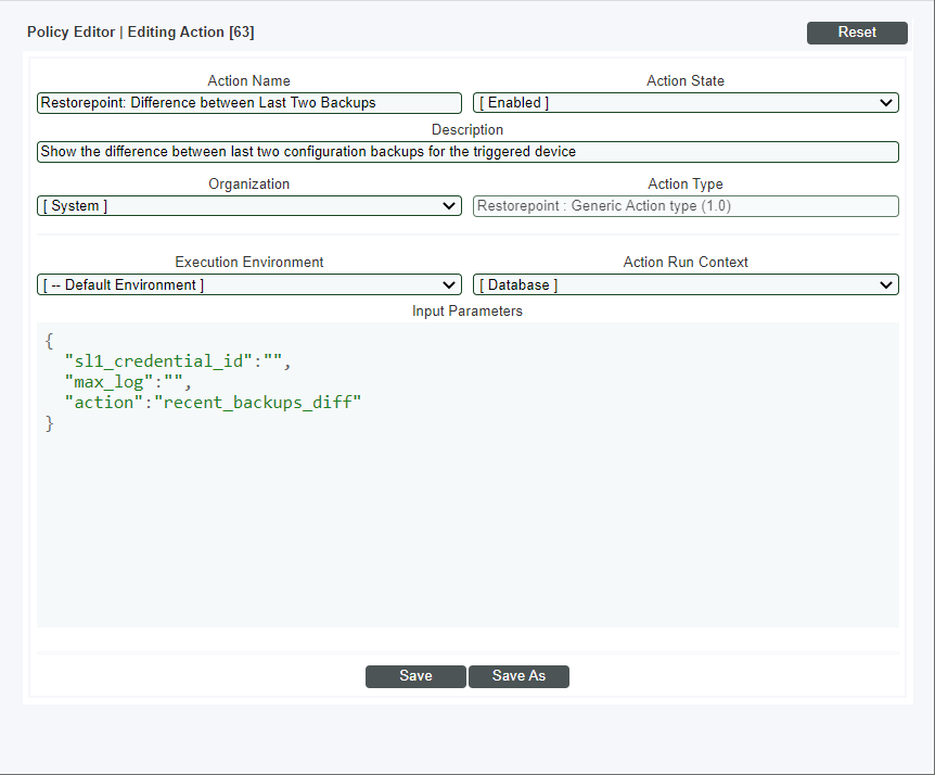

  • In the Action Policy Editor page, supply a value in each field:
  • Action Type. Type of action that will be executed. Select the "Restorepoint: Generic Action type" action type (highlighted in the figure above).
  • Input Parameters. A JSON structure that specifies each input parameter. Each parameter definition includes its name, data type, and whether the input is optional or required for this Custom Action Type. Input parameters must be defined as a JSON structure, even if only one parameter is defined.
  • Click [Save]. If you are modifying an existing action policy, click Save As. Supply a new value in the Action Name field, and save the current action policy, including any edits, as a new policy.

An image of the Editing Actions page.
The following automation actions that use the "Restorepoint: Generic Action type" action type are included in the PowerPack. Compare the commands run with the example in the image above.
