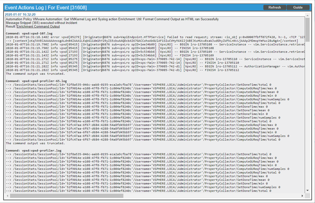

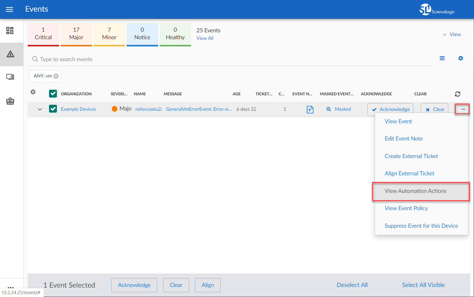

The following figure shows a VMware event with major criticality on the Events page. Click the [Actions] button (actions icon) for an event, and select View Automation Actions to see the run book actions triggered by the events.
The results shown for this event, in the Event Actions Log, include the automation policy that ran (shown at the top of the following figure), along with the log files collected.

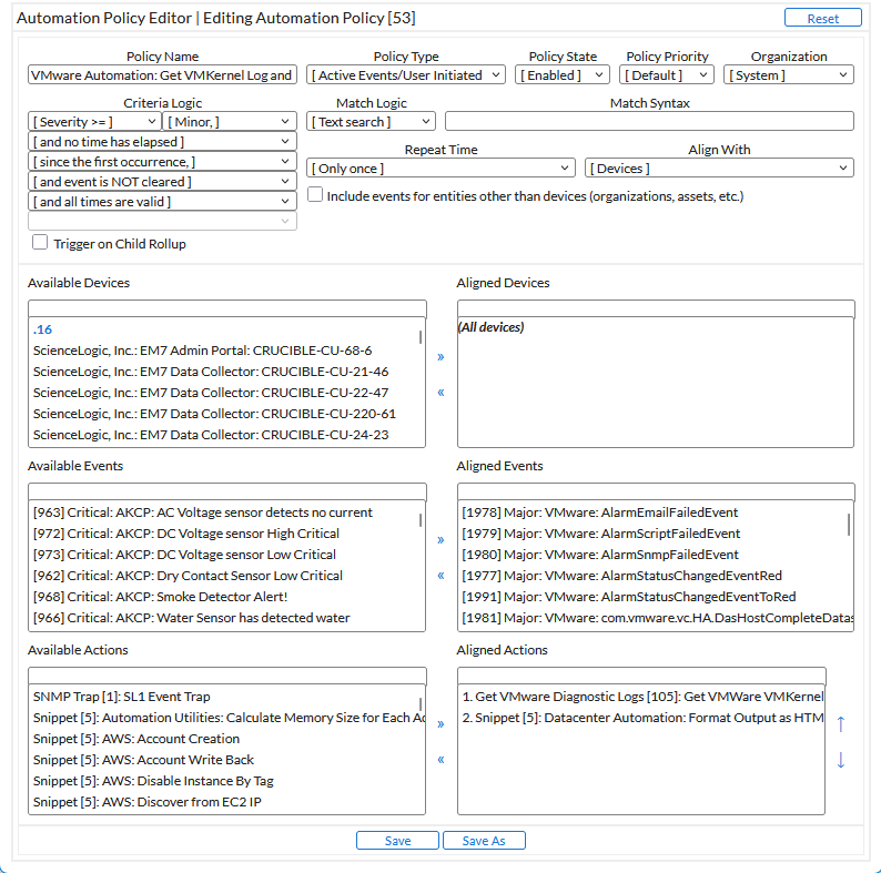

  2. Click the Create button to create an automation policy, or search for an existing automation policy that you want to edit and click the wrench icon (wrench icon) for that policy. The Automation Policy Editor page appears:
  1. Complete the following required fields:
    • Policy Type. Select whether the automation policy will match events that are active, match when events are cleared, or run on a scheduled basis. Typically, you would select Active Events or Active Events/User Inititiated in this field.
    • Organization. Select one or more organizations to associate with the automation policy. The automation policy will execute only for devices in the selected organizations (that also match the other criteria in the policy). To configure a policy to execute for all organizations , select System without specifying individual devices to align to.
    • Aligned Actions. This field includes the actions from the "VMware Automation" PowerPack. To add an action to the Aligned Actions field, select the action in the Available Actions field and click the right arrow (>>). To re-order the actions in the Aligned Actions field, select an action and use the up arrow or down arrow buttons to change that action's position in the sequence.
  3. Click Save or click Save As if you are customizing an existing policy. If you modify one of the included automation policies and save it with the original name, any customizations you made to that policy will be overwritten when you upgrade the PowerPack.
