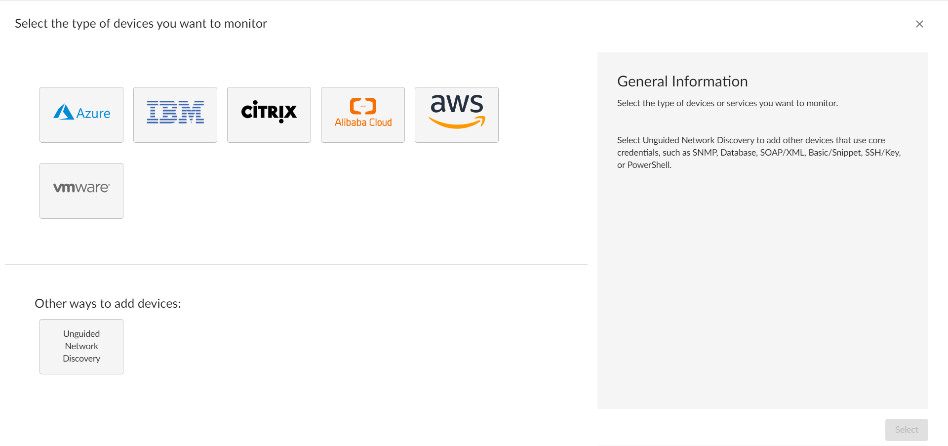

The guided discovery process lets you select a discovery type specific to the type of devices you want to monitor, in addition to traditional SNMP discovery. The guided discovery wizard provides a filtered list of relevant credentials, the ability to create new credentials, and a reduced set of application-specific fields to help you efficiently discover the devices you need.
To discover your vCenter server using guided discovery:
  2. Select the VMware discovery type. Additional information about the requirements for device discovery appears in the General Information pane to the right.

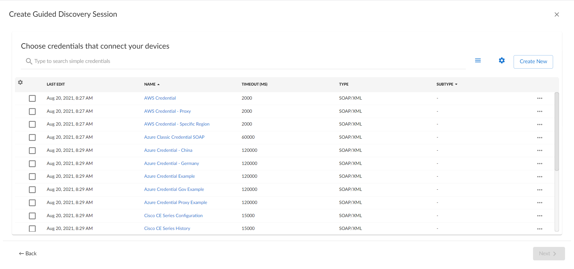

  1. Click Select. The Credential Selection page appears, which is the first step in the guided discovery session:
  1. On the Credential Selection page, select the VMware credential you configured.
  1. On the Credential Selection page of the guided discovery process, select a credential to allow Skylar One to access the vCenter server, and then click Next. The Root Device Details page appears, which is the second step in the guided discovery session:

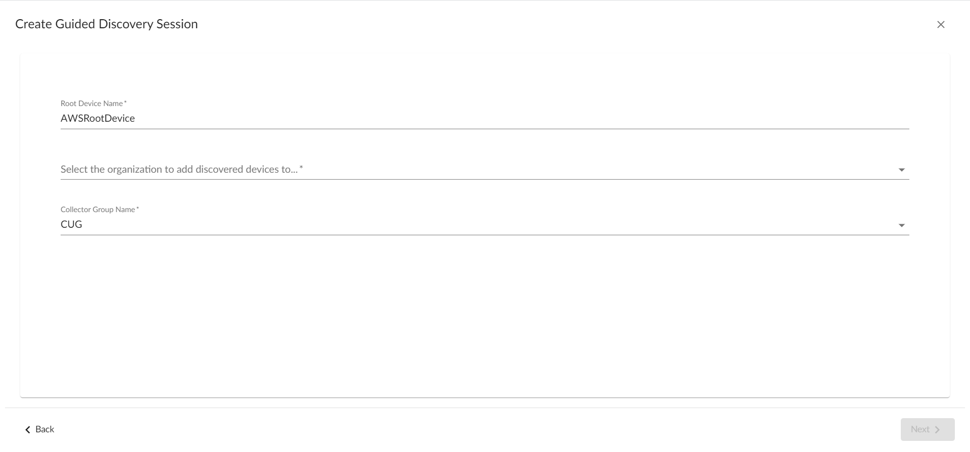

Image of the Root Device Details page
  • Root Device Name.  Type the name of the root device for the application you want to monitor (in this case, an Amazon Web Services root device).
  • IP Address. Enter the IP address for the vCenter server.
  • Select the organization to add discovered devices to. Select the name of the organization to which you want to add the discovered device.
  • Collector Group Name. Select an existing collector group to communicate with the discovered device. This field is required.
  1. Click Next. Skylar One creates a root device with the appropriate Device Class assigned to it and aligns the relevant Dynamic Applications. The Final Summary page appears, which is the third and final step of the guided discovery session:

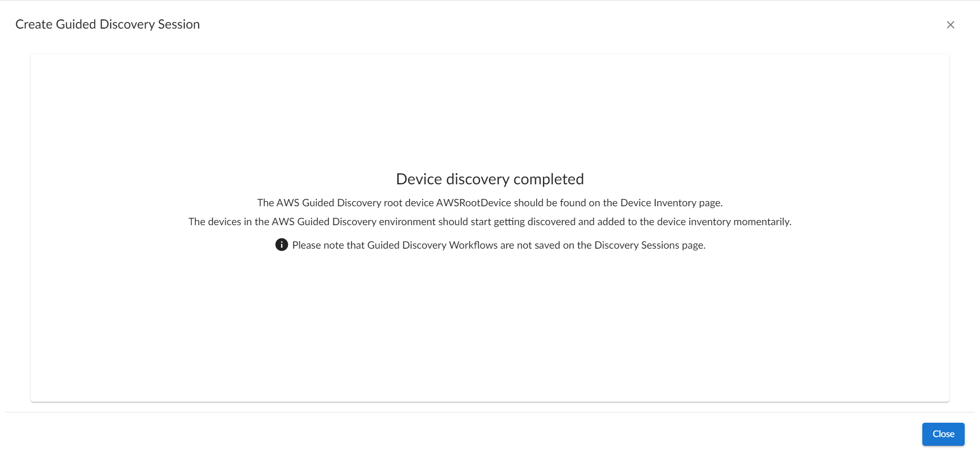

Image of the Final Summary page
  1. Click Close.
The results of a guided discovery do not display on the Discovery Sessions page (Devices > Discovery Sessions). However, you can retrieve details of saved Guided Discovery Sessions with the guidedDiscoverySessions GraphQL query. Details for discovery sessions that create a virtual root device are not currently displayed in the user interface.
