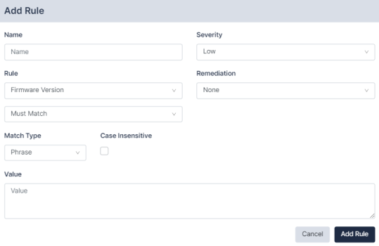

Click Add rule located in the Rules tab of the Add new device policy page to define and add a rule to a policy. Once a rule is defined, it can be edited, removed, cloned, or tested against an existing backup using the appropriate buttons. When finished, click Save Changes.
Supply values in the following fields:
  • Rule Name. A label that is used to identify a rule in a report or email.
  • Rule Type. Whether the rule applies to a configuration, software version, runtime command, or the output of a scheduled action.
  • Requirement. Select whether the rule Must Match or Must Not Match from the drop-down field.
  • Match Type. Phrase, Regular Expressions, Lua function, device, or device templates. The Phrase match type matches any (case sensitive) number of characters, including multi-line. The Regex match type (see Regular Expressions) takes a Perl-flavoured regular expression, and applies it to the whole configuration, or firmware string.
  • Severity. Select an alert level of None, Low, Medium, or High.
  • Remediation Type. Select a remediation type of None, Manual, Automatic, or Command. For more information, see Remediation.

Items defined in this section can be used in compliance rules as variable replacements, referenced with the $replace$ format, where replace is the variable you have defined. This enables you to use a variable as shorthand for configuration elements, that are likely to be referenced multiple times.
For example, if you create a definition for Gateway, and assign it a Value of 192.168.0.1, you can then use it in a compliance rule, as shown below:
Image of the Restorepoint Add Rule page
This rule will be expanded to ip default-gateway 192.168.0.1. If the gateway address changes, update the Value in the Gateway variable definition and all rules that use the $Gateway$ variable will be automatically updated.
A variable name can only consist of letters, numbers, and the underscore character _. If the value contains escape sequences (such as \n), the sequence must be double-escaped (\\n).
