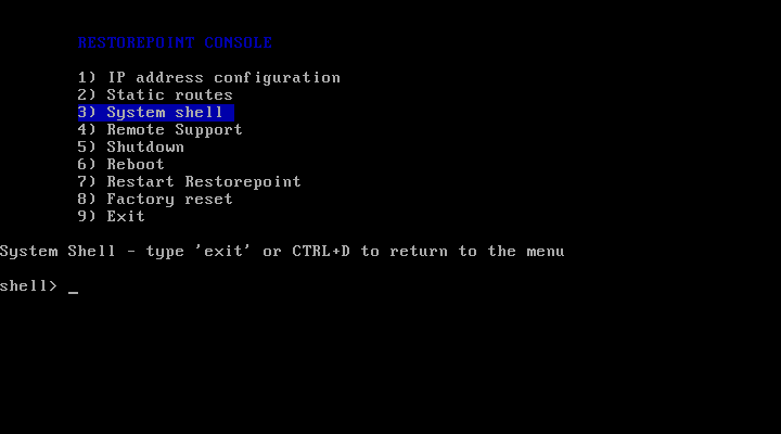

Using the System Shell
The system shell provides some useful command line network tools that can be used to troubleshoot connectivity problems. To start the system shell, log in to the Skylar Compliance console using an admin account and select System Shell.
Image of the Restorepoint Agent Console
Ensure that you are familiar with these tools before using the system shell. The available commands are:
  • help. Lists the available commands.
  • ping. Sends an ICMP Echo Request packet to a network host.
  • traceroute. Displays the route packets take to a network host.
  • nslookup. Query a DNS name server.
  • telnet. Connect to a host using the TELNET protocol.
  • ssh. Connect to a host using the SSH protocol.
  • tcpdump. Displays the network traffic.
  • exit. Returns you to the main menu.
