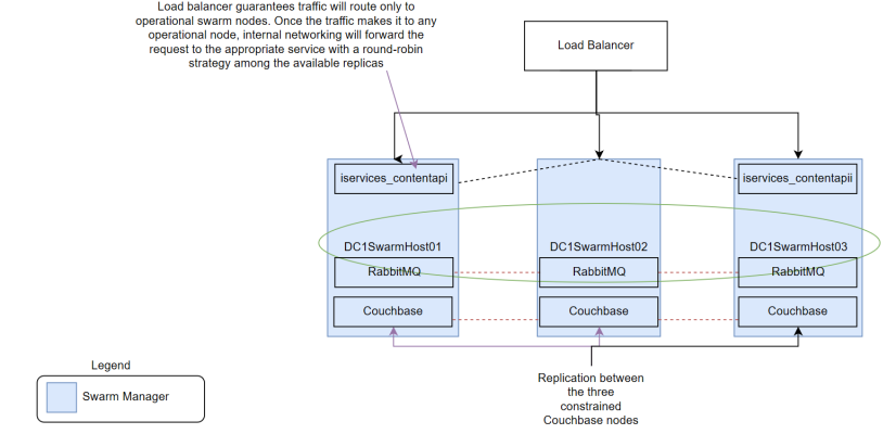

Standard Three-node Cluster (3 Nodes)
The following High Availability deployment is an example of a three-node cluster:
  • Each node in the Swarm is a Swarm Manager.
  • All Swarm nodes are located within the same data center.
The three-node cluster is the most basic option providing full High Availability and data replication support among three nodes. In this deployment, each of the three nodes are running the same services in a clustered environment, which provides failover and data loss prevention capabilities. This deployment option will satisfy most High Availability needs, but it does not mitigate risks with the potential for worker operations to affect and degrade the database and queue services, because all services are running on the same nodes.
For AWS environments, use an RPM installation instead of an ISO. For vSphere/vCenter deployments, required ports are configured automatically. Other environments might require manual port configuration.
This deployment provides:
  • Automatic failover for one out of three node failure: If one node in the cluster fails, automatic failover occurs, and the Skylar Automation will continue to be operational running on two out of three of the nodes.

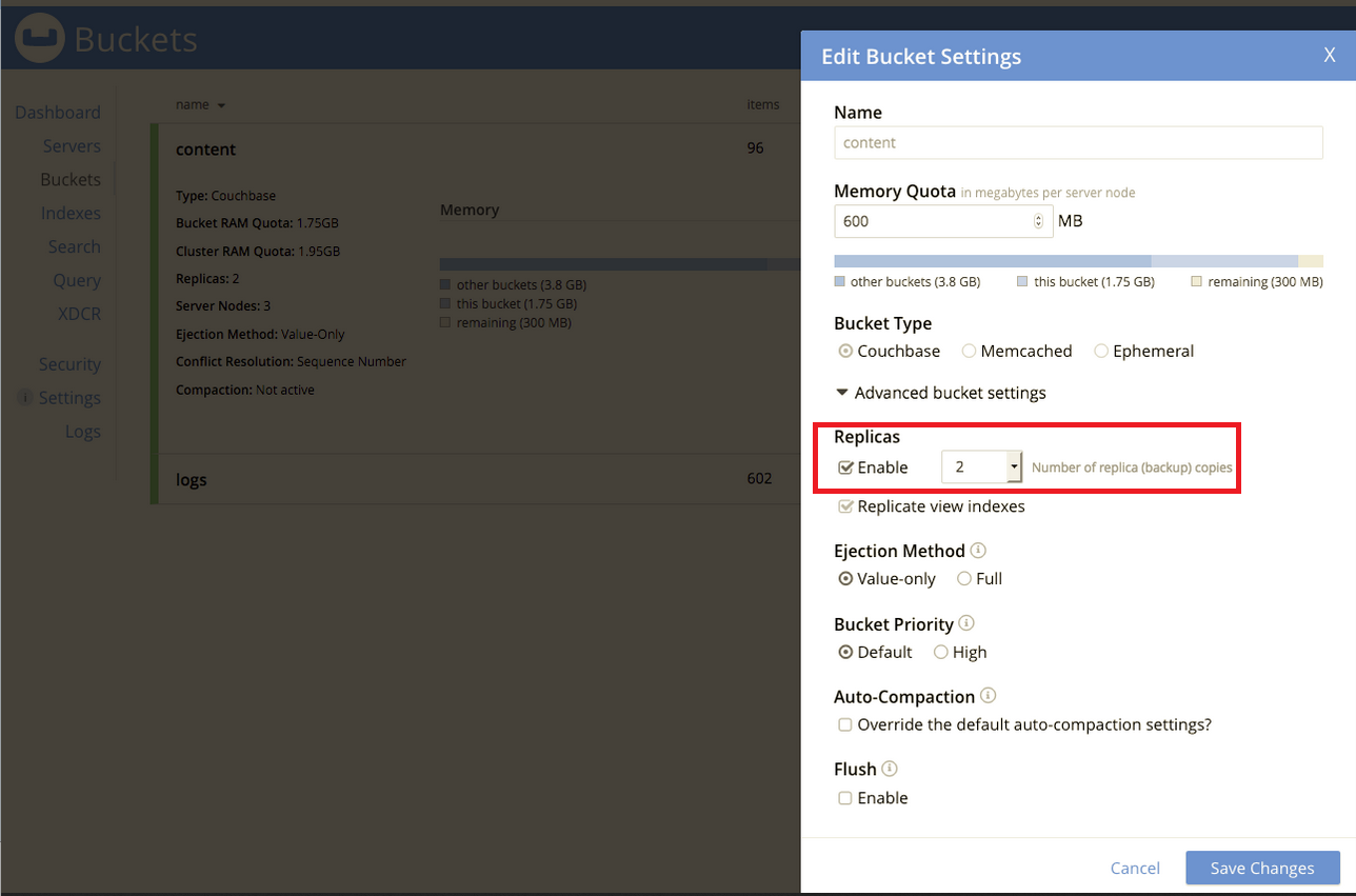

  • Full data replication between all three nodes. All nodes have a copy of the same data replicated across all three nodes. If one or two nodes fail, you will not experience data loss in the database or in the queues.
  • Full queue mirroring between all three nodes. All nodes have a mirror of the queues defined in the Skylar Automation environment. If one or two nodes fail, the system still retains messages in queues using the autoheal policy by default. For more information about autoheal behavior in RabbitMQ, see The RabbitMQ Split-brain Handling Strategy.

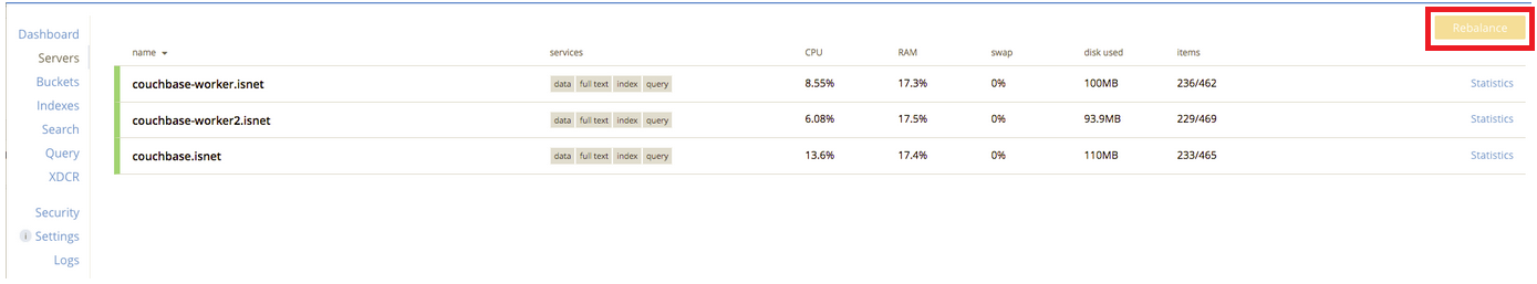

  1. Validate the deployment on the main manager node using the following commands:
docker service ls
docker node ls
Validation for Manual and Automated Deployments
The following services are expected to be running:
  • Steprunners services. Correct count is dependent on the docker-compose-override.yml configuration.
  • ContentAPI, Graphical User Interface, Dexserver. Three replicas each.
  • RabbitMQ. Three services running: rabbitmq, rabbitmq2, and rabbitmq3.
  • Couchbase. Three instances running: couchbase, couchbase-worker, and couchbaser-worker2.

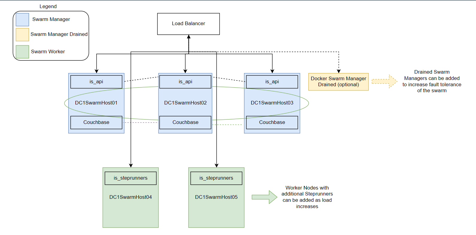

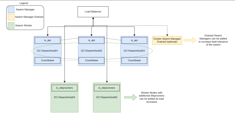

3+ Node Cluster with Separate Workers (4 or More Nodes)
The three-node cluster with separate workers is a slight variation of the standard three-node cluster. With this deployment strategy, all worker operation load is run by a separate independent node. This is preferable over the standard three-node deployment, because it completely prevents worker operations from stealing resources from the databases or queues.
Since steprunner workload is entirely on dedicated servers, you have greater ability to scale up to more workers, or even add additional nodes of workers to the system, without affecting critical database or queue operations.
This deployment provides a complete separation of worker processing from the database and queue processing, which is very helpful for users which have very CPU-intensive tasks that execute frequently.
The following High Availability deployment adds Docker Swarm worker nodes where steprunners can be constrained. This lets you continue to scale out new worker nodes as the load increases. This also lets you distribute steprunners based on workloads. Core services include ContentAPI, RabbitMQ, and Couchbase.
You can add drained Docker Swarm Manager nodes to increase fault tolerance of the Swarm, and to ensure that the orchestration of the Swarm is not impeded by large workloads on the core nodes.
The maximum Couchbase cluster with fully replicated nodes is four. Anything greater than four will not have a full replica set and will auto-shard data across additional nodes. There is no way as of this version of Couchbase to set the placement of the replicas. Redis replication and clustering is not currently supported in this version of Skylar Automation.

Configuration
Using this configuration consists of:
  • Expanding your existing three-node cluster by adding dedicated worker nodes. The original three nodes remain as Docker Swarm managers, while new nodes join as Swarm workers dedicated to running steprunner workloads.
You must have a functioning three-node cluster (three manager nodes) before adding worker nodes.
  • Labeling each additional "worker" node with a Swarm label "worker". For more information, see Creating a Node Label. You can also use the worker node role to restrict the steprunners to run only in the Swarm worker nodes using node.role==worker in the constraints section in the docker-compose file.

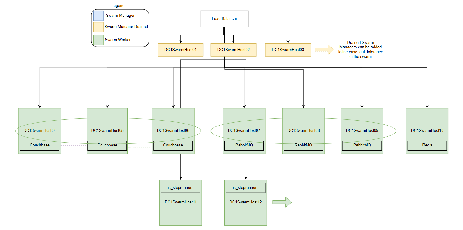

3+ Node Cluster with Separate Workers and Drained Manager Nodes (6 or More Nodes)
This deployment option is the most robust of the one-node auto-failover deployments, and completely mitigates known risks for resource contention in clusters.
This configuration provides everything that the 3+ node cluster with dedicated workers provides, with the addition of drained Swarm Managers. The drained Swarm Managers mitigate the risk of database or queue processing causing contention of resources for the Swarm clustering operations at the host level.
This deployment should only be used for large deployments of Skylar Automation. This deployment separates out all the core services onto their own dedicated worker node and lets you distribute steprunners based on workloads:

Use the same docker-compose-override.yml file found in Standard Three-node Cluster (3 Nodes).
Next, add the additional three nodes to the cluster as managers, and drain them of all services (see Using Drained Managers to Maintain Swarm Health). Promote the drained nodes to Swarm Managers, and make all other nodes workers.

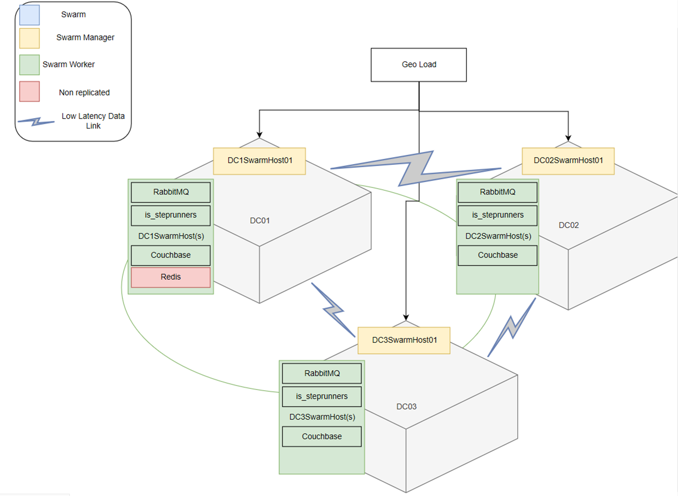

Cross-Data Center Swarm Configuration

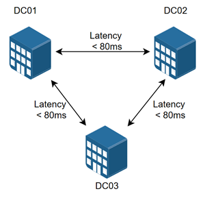

Docker Swarm requires three data centers to maintain quorum of the swarm in the event of a full data center outage. Each data center must have a low-latency connection between the data centers.
Implementing clustering across links with a latency that is greater than 80 ms is not supported, and may cause one or more of the following situations: nodes dropping out of the cluster, or automatically failover, failed data replication, and potential cluster communication issues resulting in timeouts and significantly increased overhead.
The cross-data center configuration has the following limitation: the Redis service cannot be deployed in High Availability. As a result, all task results saved by any steprunner will have to be saved within that data center. Upon a failure of that data center, a new Redis service will be created, but an application in the middle of its run would have to retry.
The following High Availability deployment shows a cross-data center swarm configuration:

  1. After the two-node Couchbase cluster has been successfully deployed and the secondary indexes are successfully added, edit the replicas on couchbase-worker2 to 1 and run the following command:
    docker stack deploy -c <location of compose file> iservices
  1. Set the replicas in the docker-compose-override.yml file as well.
  2. After the second worker is added, set the number of replicas to "2" on each bucket (content and logs) in the Couchbase Administrator user interface and click Save Changes:
  1. Rebalance the cluster by navigating to the Servers section of the Couchbase Administrator user interface and clicking the Rebalance button:

To scale out iservices_contentapi to distribute the service across the three nodes, run the following command:
docker service scale iservices_contentapi=3

  5. One of the previous commands will show one or two failed nodes. Copy the Couchbase node names for step 8.
  6. Use the currently running node (operating-couchbase-node) and the failed node's names to run the following command to failover:
    couchbase-cli failover -c <operating-couchbase-node>:8091 -u isadmin -p <password> --server-failover <failed-couchbase-node>:8091 --force
    For example, if the operating node is couchbase-worker, and the isnet name:port of the failed service is couchbase.isnet:8091, then the command would be:
    couchbase-cli failover -c couchbase-worker:8091 -u isadmin -p <password> --server-failover couchbase.isnet:8091 --force
    If the command fails and suggests using the --hard argument, then the command would be:
    couchbase-cli failover -c couchbase-worker:8091 -u isadmin -p <password> --server-failover couchbase.isnet:8091 --force --hard
    Execute the command above for both failed nodes. If the command returns an error, run the following commands to sendboth failed nodes as part of the command. This is likely to happen if both unhealthy nodes went down at the same time.
    couchbase-cli failover -c <operating-couchbase-node>:8091 -u isadmin -p <password> --server-failover <failed-couchbase-node>:8091,<second-failed-couchbase-node>:8091 --force
    couchbase-cli failover -c <operating-couchbase-node>:8091 -u isadmin -p <password> --server-failover <failed-couchbase-node>:8091,<second-failed-couchbase-node>:8091 --force --hard
  7. Rebalance the cluster using the functioning container name:
    couchbase-cli rebalance -c <operating-couchbase-node>:8091 --server-remove <failed-couchbase-node>:8091 --server-remove <second- failed-couchbase-node>:8091 -u isadmin -p <password>

Couchbase-worker fails to connect to master
A connection failure might happen a few times when a stack is freshly deployed. You can ignore these messages, and the worker should eventually connect to the master.
