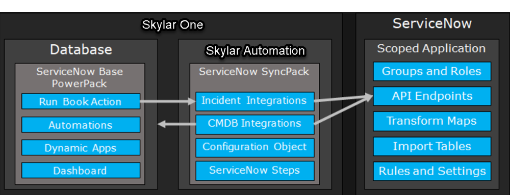

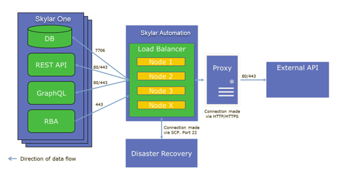

Architecture Overview for ServiceNow SyncPacks
The following diagram details the various elements that are contained in Skylar One and the Skylar Automation system, and how Skylar Automation sits between the core Skylar One platform and an external data platform:
The following diagram provides an example of the high-level architecture of a Skylar Automation system with High Availability, Disaster Recovery, and a proxy configured:

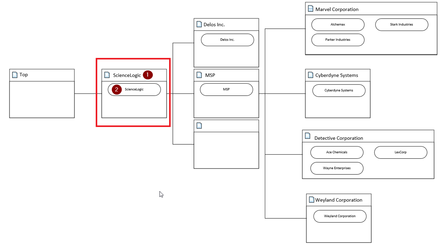

Installing the ScienceLogic Domain Separation (Global) Update Set in ServiceNow
If your ServiceNow environment is domain-separated, where the data, processes, and administrative tasks have been organized into logical groupings called domains, you will need to install the latest version of the "ScienceLogic Domain Separation (Global)" update set in ServiceNow. This update set is not included in the "ScienceLogic Skylar One: CMDB & Incident Automation" application (also called the Certified application).

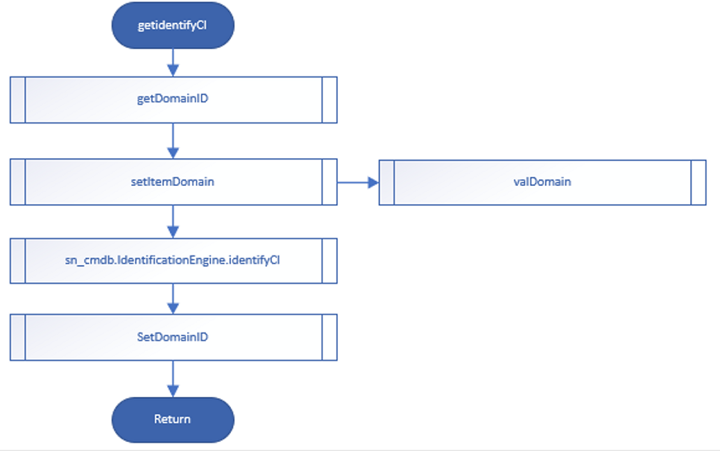

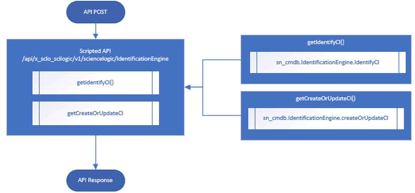

This update set completely separates the ServiceNow Identification Engine REST resource that is used in the "ScienceLogic ServiceNow Integration" application and all of the required resources and duplicates it in the Global scope.
A Scripted REST Service in the Global application is a direct copy of the application endpoint with a new name: api/10693/sciencelogic_domain_separation. This REST Service includes only one Resource: Device IdentificationEngine POST. This resource works exactly like the application version, but it points to the new Script Include "SciLoDomainSepUtil". This version of the REST resource takes the same formatted JSON as the Certified application.
The Script Include "SciLoDomainSepUtil" includes all of the functionality needed to run the ServiceNow Identification Engine API.
Additional resources for the ServiceNow API:
The only resource shared with this update set and the Certified application is the Device Properties page. These properties are located in the Certified application at ScienceLogic > Device > Device Properties.
Limitations of the Identification Engine
For more information about how the Identification Engine handles incoming payloads in domain-separated systems, see the following ServiceNow Knowledge Base article: KB0695949.
The payload and the user domain must match, or the ServiceNow Identification Engine (IDE) will by default insert the CMDB record. Safeguards within the Skylar Automation Device Sync application were put in place for payloads that have relationships. The application will drop the payload if all Configuration Items do not share the same domain.

Example 1
In the following example, ScienceLogic (1) is both the domain and the company. The ScienceLogic user service account is associated with ScienceLogic (2) company, and it will have access to all child domains. You do not need to set visibility to any domain. This is the best way to set up this user, because placing it in the top domain ensures that it always has access to all children:

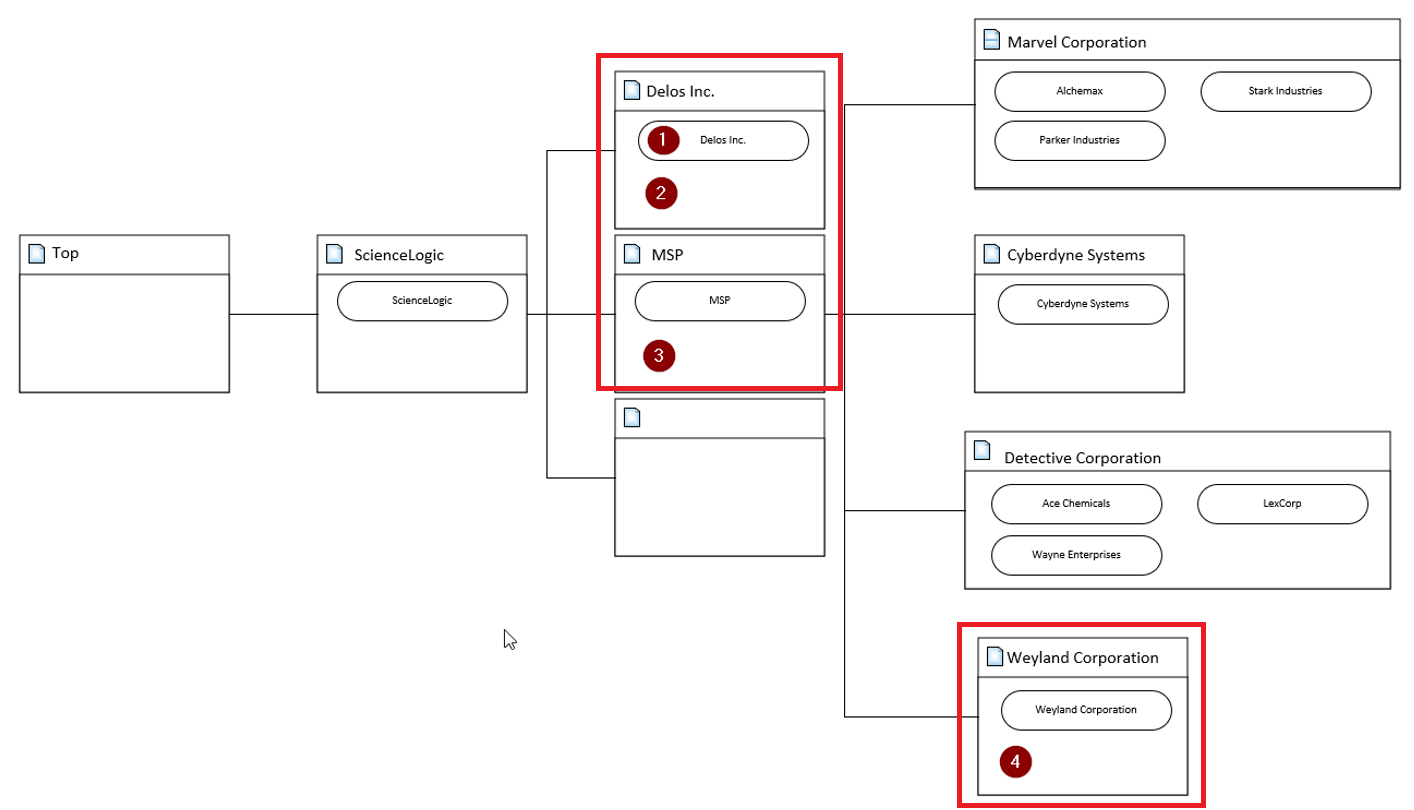

Example 2
In the following example, Delos Inc. (1) is the company within the Delos Inc. domain. The Skylar Automation service account is associated with the Delos Inc. (1) company. The Delos Inc. domain has no children domains, and if domain visibility is not assigned, Skylar Automation will not properly update the CMDB. This setup works, but it requires that proper domain visibility is set up for the service account to work correctly.
Assigning visibility to MSP (3) will grant the service account access to all child domains. Assigning visibility to Weyland Corporation (4) will only allow access to the Delos Inc. domain and the Weyland domain; all other domains will not work.
