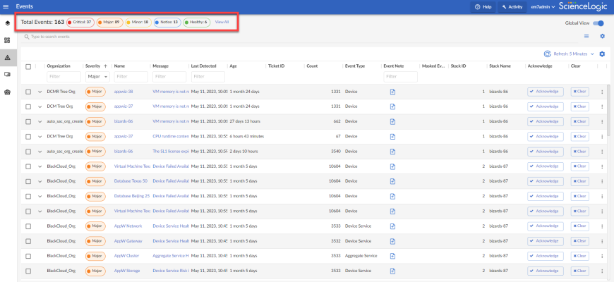

Searching and Filtering the List of Events
This section explains how to filter the list of events so you can quickly locate and address any potential issues in your environment.
Filtering Events by Severity
The Events page displays a list of currently active events, which can be sorted by any column, such as severity from critical to healthy. You can filter the list of events by severity by clicking one or more of the five colored buttons near the top of the Events page:
When you click a severity button, the list displays only events with the severity you selected. The severity button you clicked remains in color, while the other buttons turn gray.
To clear a severity filter, click the View All link next to the severity buttons.

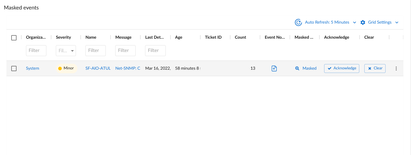

Filtering for Masked Events
When a device uses the event mask setting, events that occur on a single device within a specified span of time are grouped together, and only the event with the highest severity is displayed on the Events page. This allows related events that occur in quick succession on a single device to be rolled up and posted together under one event description. For example, if a device cannot connect to the network, multiple other services on the device raise events. Skylar One displays the event with the highest severity and rolls up all the other events.
On the Events page, any event that contains masked events includes the masked events icon (masked events icon) in the Masked Events column.
Click the Grid Settings button to add the Masked Events column, if it is not currently visible.
To view more information about masked events, click the masked events icon (masked events icon) in the Masked Events column on the Events page. The Masked Events Overview modal appears, where you can view details about the masked events.
  1. On the Events page, click the masked events icon (masked events icon) in the Masked Events column for the relevant event. The Event Investigator page for that event appears.
  1. Scroll down to the Masked events section to view the details about the masked events:
The Masked events section in the Events page

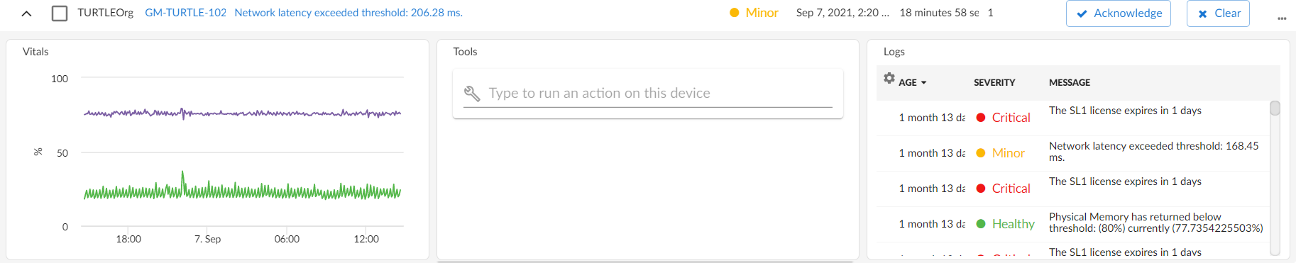

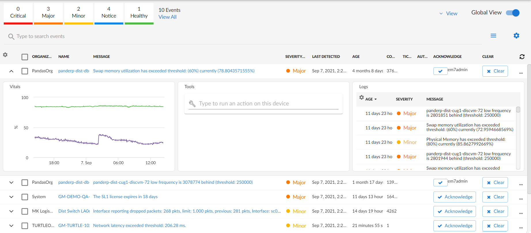

On the Events page, you can click the down-arrow icon (down-arrow icon) next to the name of an event to open a drop-down panel called the Event Drawer. The Event Drawer contains additional data about that event:
Image of the Event Drawer
The Event Drawer displays only for events that are aligned with devices.
On the Event Drawer, you can access the following panes:
  • The Vitals pane displays graph data for the past 24 hours of CPU and memory usage for the device related to the event. You can zoom in on a shorter time frame by clicking and dragging your cursor over a time frame, and you can go back to the original time span by clicking the Reset zoom button.
  • The Tools pane enables you to run a set of network diagnostic tools or user-initiated actions in the Activity Center page. Click the search bar to search for a tool or action to run, or click one of the default tools or actions that are available based on the device type and your user permissions. For more information, see the section on Using the Action Runner.
  • The Logs pane displays a list of the log entries from the device's log file, sorted from newest to oldest by default.

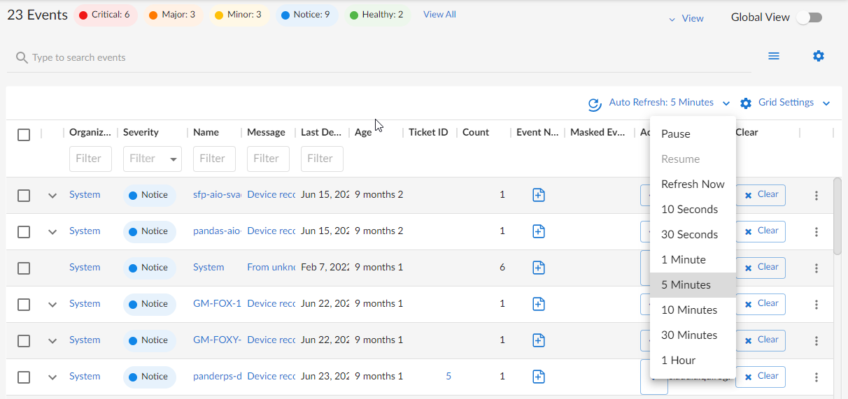

To view a log of automated actions that have occurred for an event, on the Events page, click the actions icon (actions icon) for the event and select View Automation Actions. When you do so, the Event Actions Log modal appears.
You can also view the Event Actions Log modal by clicking the hyperlink in the Automated Actions column for a particular event on the Events page.
The drop-down menu from the Actions button
The Event Actions Log displays a history of all automation actions that Skylar One executed in response to the event.
Each entry in the Event Actions Log modal includes:
  • The date and time when the action was executed
  • The automation policy that triggered the action
  • The name of the action policy
  • The result of the action
Refreshing the Events Page
You can refresh the Events page manually or set it to auto-refresh.
To refresh the Events page manually, click the auto-refresh icon (auto-refresh icon) and select Refresh Now.
To enable auto-refresh:
  1. On the Events page, click the Auto Refresh drop-down menu.
  2. In the Refresh interval drop-down field, select the desired refresh interval for the page. Options range from 10 seconds to 60 minutes.

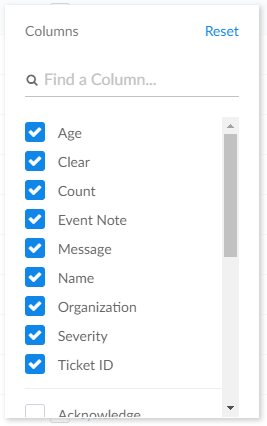

You can deselect columns that you do not want to see in the Events page, and select additional columns including custom attributes.
To select columns:
  1. Click on the gear icon (gear icon) in the top left of the Events page.
  2. In the Columns menu, select the columns you want to add or deselect columns you want to hide. If you cannot find a column, use the search field to find it by name. If you have created any Custom Attributes, these will appear in this list as well:
For more information about Custom Attributes, see the section on Custom Attributes.
  1. When you have finished making your selections, click outside the Columns menu to close it.

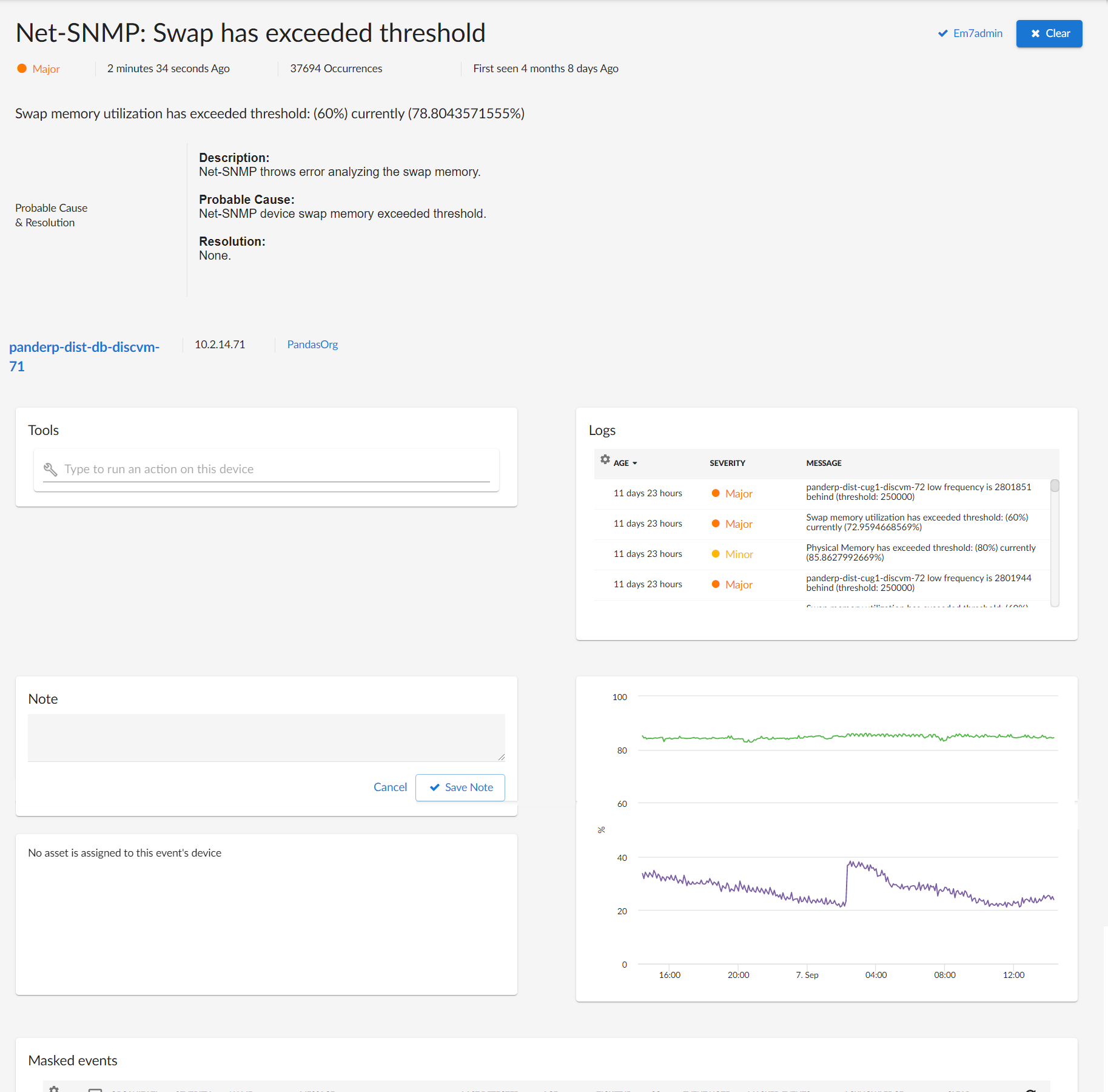

Using the Event Investigator
The Event Investigator page provides details about the event as well as the device associated with the event, where relevant. The Event Investigator page includes sections for Probable Cause & Resolution, Tools, Logs, Notes, Assets, a Vitals widget, and a list of masked events:
To get to the Event Investigator page, click the linked text in the Message column of the Events page, or click the actions icon (actions icon) for the event and select View Event.
The top pane of the Event Investigator page contains basic event details. From this pane, you can also acknowledge or clear the event.
On the Event Investigator page, click the name of an aligned device to go to the Investigator page for that device. You can also click the name of the aligned organization to view its Organizational Summary page.
The Event Investigator page includes the following sections:
  • Probable Cause & Resolution. Displays additional information about the event, based on the event policy.
  • Tools. A set of network diagnostic tools or user-initiated actions that you can run on the device associated with the event. Click the search bar to search for a tool or action to run, or click one of the default tools or actions that are available based on the device type and your user permissions. This pane is the same as the Tools pane of the Event Drawer. For more information, see the section on Using the Action Runner.
  • Logs. A list of log entries from the device's log, sorted from newest to oldest by default.
  • Note. A text field where you can add new text and edit existing text related to the event and the device associated with the event. For more information, see Viewing and Editing Event Notes.
  • Assets. One or more asset records associated with the device, such as a piece of equipment owned by an organization. The asset record includes contact information for the technician, administrator, and vendor for that device. You can click the name of an asset to view an Asset page for more information.
  • Vitals. A widget that displays the past 24 hours of CPU and memory usage for the device related to the event. You can zoom in on a shorter time frame by clicking and dragging, and you can go back to the original time span by clicking the Reset zoom button.
  • Masked events. A list of all masked events for the device. When a device uses the event mask setting, events that occur on a single device within a specified span of time are grouped together, and only the event with the highest severity is displayed on the Events page. This allows related events that occur in quick succession on a single device to be rolled up and posted together under one event description.

  1. To acknowledge an event, find the event on the Events page and click the Acknowledge button for that event. Your user name replaces the Acknowledge button for that event.
You can also click the Acknowledge button in a specific event's Investigator page.
  1. To see when an event was acknowledged and who acknowledged it, hover your mouse over an acknowledged field.
  2. If an event was acknowledged by another user and you have the relevant permissions, you can click the Reacknowledge button to acknowledge that event.
  3. To clear an event, click the Clear button. The event is removed from the Events page.
If you want to hide the Acknowledge or Clear buttons on the Events page, click the gear icon (Image of the gear icon) and deselect those columns.
From the Events page, you can access event notes, which contain event definitions, probable causes, and resolutions for the event, along with a text field where you can add more information about the event or the device you are monitoring. If event notes already exist for that event, the opening text of that note appears in the Event Note column of the Events page.
To view or edit an event note:
  1. On the Events page, click the note icon (note icon) for that event. The Edit Event Note modal appears.
    You can also edit an event note on the Events page by clicking the actions icon (actions icon) for that event and selecting Edit Event Note. This is helpful if you have hidden the Event Note column on the Events page. To add or edit an event note for multiple events, check the box next to the events for which you want to edit the note, then click the Edit Note button at the top of the inventory table.
  1. Type your additional text for the event note and then click Save. The event note is updated.
