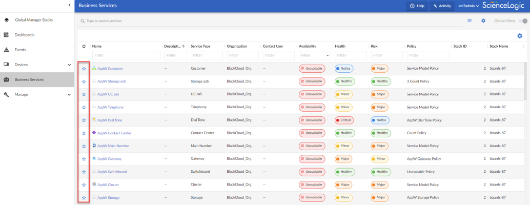

Favoriting Business Services
In Skylar One, you can select one or more services so that they always display at the top of the list on the Business Services page. This process is called favoriting services or favorite service.
For example, on the Business Services page pictured below, click the Favorite Service star icon () to add or remove the service from your favorites list. Click the icon () again to remove the favorite status.
You can then sort your Business Services by their favorite status.
With favorite services, you can:
  • View your favorite service at the top of the Business Services page by default.
  • Filter services by favorite.

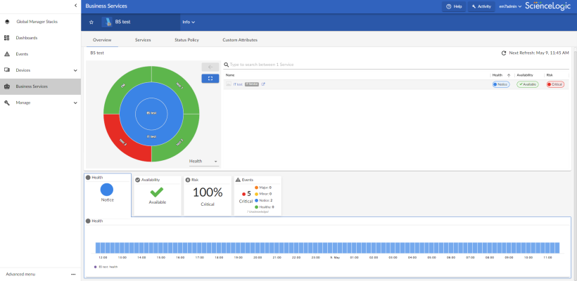

The Overview Tab
The Overview tab provides a single-page view of your services. This tab enables users to determine the behavioral correlation between a service's health, availability, and risk values and the events, anomalies, or other causes that might be impacting those values. This behavioral correlation feature provides users with a "big picture" view of the service and enables them to determine the root cause of any problems the service might be experiencing and then troubleshoot those problems.
The Overview tab consists of the following widgets:
Each of these widgets is described in the following sections.
Sunburst Widget
The top dashboard widget of the Overview tab displays either a Sunburst chart view or a Map view of your services. Use the drop-down menu in the top left corner of the widget to select which view you want to appear.
When you select the Sunburst view:
  • The left pane includes a sunburst chart that displays the current Health, Availability, and Risk values for the service, as well as for any constituent IT services or device services that belong to that top-level service. For device services, the sunburst includes the device name and Health values for any devices that belong to the service. Additionally, this pane indicates the maximum number of constituent services or devices that will be used for computing health, availability, and risk.
  • The right panel includes a list of constituent services or devices. Each service in this panel includes icons that represent that service's Availability, Health, and Risk metrics; devices include icons that represent each device's Health value. The right panel also includes a search bar at the top of the panel that enables you to search for specific constituent services or devices.
In the sunburst chart, the center circle represents the selected service. The selected service drives the context for the page title and Info drawer, as well as all the other panels and widgets on the Overview tab. This means that the right panel, widgets, and other elements on the page will all reflect the metrics for the service in the center circle of the sunburst.
You can navigate through services on the widget in the following ways:
  • In the left panel, you can click any of the constituent IT services or device services in the sunburst to select that service. To return to the parent IT service or business service, click the center circle or click the Back button.
  • In the right panel, you can click the service name of any of the constituent IT services or device services to select that service. To return to the parent IT service or business service, click the breadcrumb links that appear in the top-left corner of the widget.
By default, the sunburst displays the Health value for the selected service and its constituent services or devices. To view the current Availability or Risk value for the selected service, click the drop-down button in the lower-right corner of the left pane and select Availability or Risk.
To collapse the sunburst widget, click the up arrow icon () in the top-right corner of the widget. To reopen it, click the down arrow icon ().

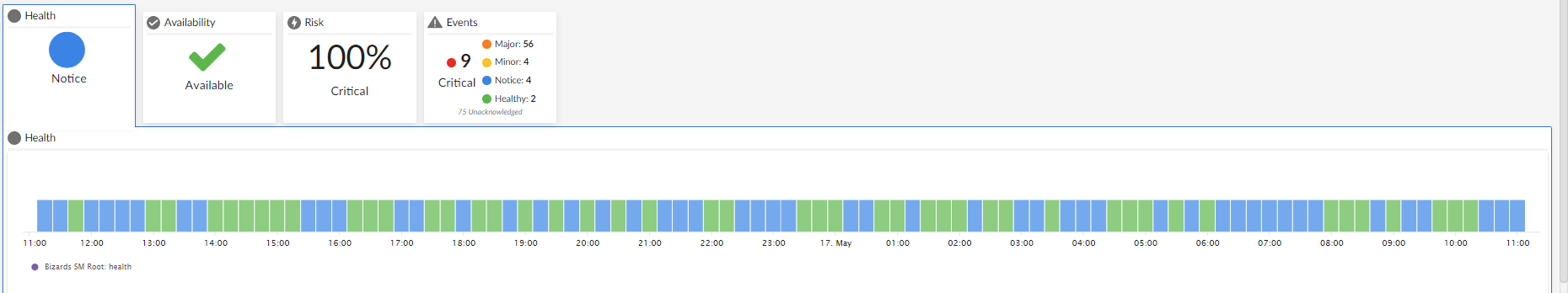

Health, Availability, and Risk Widgets
The Health, Availability, and Risk widgets display a time series chart with the historical values of those metrics for the selected service from each polling cycle over the previous 24 hours.
From these widgets, you can do the following:
  • Hover your mouse over the chart to view the value for each polling cycle from the previous 24 hours.
  • Click and drag your mouse over a series of bars in the chart to zoom in on that specific timespan. To return to the 24-hour view, click Reset zoom.
  • Click a specific polling cycle to view the historic Health, Availability, and Risk values for that polling cycle.
If the RCA Options field is enabled, you can also view Root Cause Analysis information for the service to help you troubleshoot the root cause of a particular Health, Availability, or Risk value for a specific polling cycle. To view Root Cause Analysis information, click one of the polling cycles in the time series chart.
For more information about Health, Availability, and Risk, see the section Understanding Health, Availability, and Risk.

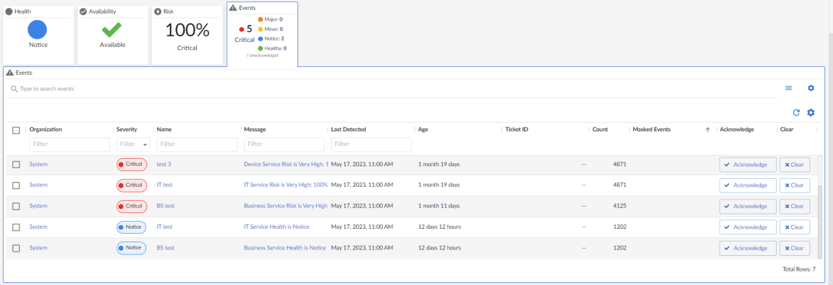

Events Widget
The Events widget displays a list of events for the selected service. This widget has much of the same functionality as the Events page.
The Events widget tile displays the number of events of each severity type, after masking, that are currently impacting the service. When opened, the Events widget lists all events impacting the service, including masked events. Therefore, the number of events that appear in the widget tile might be smaller than the number of events that appear in the opened widget.
From the Events widget, you can do the following:
  • Use the search field to search for specific events.
  • For events that are aligned to devices, click the down-arrow icon () next to the event to open the Event Drawer panel, which displays the following panes:
  • Vitals. A widget displaying the past 24 hours of CPU and memory usage for the device related to the event. You can zoom in on a shorter time frame by clicking and dragging, and you can go back to the original timespan by clicking the Reset zoom button.
  • Tools. A set of network diagnostic tools or user-initiated actions that you can run on the device associated with the event. Click the search bar to search for a tool or action to run, or click one of the default tools or actions that are available based on the device type and your user permissions.
  • Logs. A list of the log entries from the device's log file, sorted from newest to oldest by default.
  • View the Organizational Summary page for the organization aligned with the event by clicking the link in the Organization column.
  • View the Service Investigator or Device Investigator page for the service or device aligned with the event by clicking the link in the Name column.
  • View the Event Investigator page for the event by clicking the link in the Message column.
  • View or edit event notes by clicking the Note icon () in the Event Note column or by clicking the Actions button () and selecting Edit Event Note. Event notes contain event definitions, probable causes, and resolutions for the event, along with a text field where you can add more information about the event or the service or device you are monitoring.
  • View more information about masked events by clicking the masked events icon () in the Masked Events column. Masked events are related events that occur in quick succession on a single device or service that are rolled up and posted together under one event description, with only the highest severity event displayed.
  • For more information on masked events, see Viewing Events.
  • Acknowledge the event by clicking the Acknowledge button. When you acknowledge an event, you let other users know that you are aware of that event, and you are working on a response.
  • Clear the event by clicking the Clear button. When you clear an event, you let other users know that the event has been addressed.
  • Create a ticket from the event.
  • View the event policy.
  • View a log of automations that have occurred for the event by clicking the Actions icon () and selecting View Automation Actions.
  • Select multiple events for action using the check boxes next to the events.
For more information about events, see the section on Events.

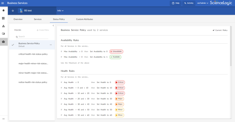

The Status Policy Tab
The Status Policy tab displays a list of all the policies of that service type that are currently in the system and that can be chosen to associate with the service being viewed.
Global Manager is read-only. For more information about selecting or changing a service policy, see the section on Selecting a Service Policy. For more information about creating a new service policy, see the section on Creating a Service Policy.
Depending on the thresholds you configured on the Business Services Thresholds page (Business Services > Thresholds), Skylar One generates an alert message if a threshold is crossed.
For more information about thresholds, see the section on Managing Service Thresholds.

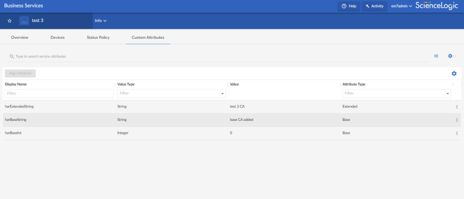

The Custom Attributes Tab
The Custom Attributes tab displays a list of all of the custom attributes that are aligned with your service.
Custom Attributes are customized name-value pairs. You can use custom attributes when importing services from an integrated system to handle incoming properties that are not defined in Skylar One.
There are two categories of custom attributes:
  • Base Custom Attributes. Base custom attributes for services are aligned to all services. Therefore, all base custom attributes in your Skylar One system that have a Resource Type of Service will appear on the Custom Attributes tab for all services. You can edit the value of a base custom attribute for a particular service, but you cannot unalign a base custom attribute from a service.
  • Extended Custom Attributes. Extended custom attributes that have a Resource Type of Service can be aligned individually to one or more services. For example, you could align an extended custom attribute only to those services to which the custom field applies. You can also edit an extended attribute value for a particular service or unalign an extended custom attribute from a service.
Custom attributes cannot be used in dashboards for business services.
For more information about custom attributes, see the section on Custom Attributes.

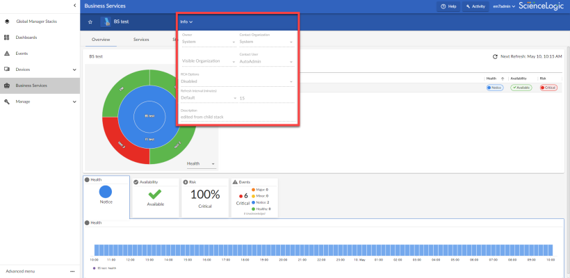

Using the Info Drawer on the Service Investigator Page
The Info drawer at the top of the Service Investigator page displays the following:
The Info drawer is read-only in Global Manager.
  • Owner. The organization that owns the service.
  • Contact Organization. The organization that should be contacted with any questions about the service.
  • Visible Organizations. A list of organizations from which you can select devices to use in Device Services or IT Services. For example, if you selected Acme for this field, then any service that is aligned with Acme can access devices in the Acme organization. This implies the devices can be included in IT Services. There are two uses for Visible Organizations:
    1. Device Services. Allow the inclusion of devices from the owning organization, as well as the visible organizations.
    2. IT Services. Allow the inclusion of Device Services from the owning organization, as well as the visible organizations.
  • RCA Options. Allows you to enable or disable the Root Cause Analysis feature, an advanced feature for troubleshooting.
  • Refresh Interval (minutes). Allows users with edit permissions to edit the Health-Availability-Risk (HAR) Har Provider's Poll Frequency time. The value allows a minimum of 1 minute and a maximum of 24 hours (in minutes). Default minute value is 15 minutes.
  • Description. A description of the service. You can use this field as a metadata tagging field that can be exploited in the search by a parent service. For example, if a collection of Device Services all have a description of "Shared Infrastructure", then an IT Service can search to include every Device Service in the same organization that has a description of "Shared Infrastructure". As you add more "Shared Infrastructure" device services, the IT Service will automatically expand to include them. This makes building service trees quick and self-maintaining, without resorting to rigid service names.
  • Include devices from visible organizations. Allows you to include devices from other organizations in a Device Service. Turn the toggle on (blue) to include other organizations' devices; turn it off (gray) to exclude other organizations' devices. This option appears only on the Service Investigator page for Device Services.
