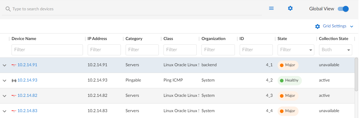

Viewing the Global List of Devices
On the Devices page, you can view all of your managed devices in Skylar One. This section explains how to gather more information about a device from this page.
To navigate to the Devices page, click the Devices icon (Devices page icon):

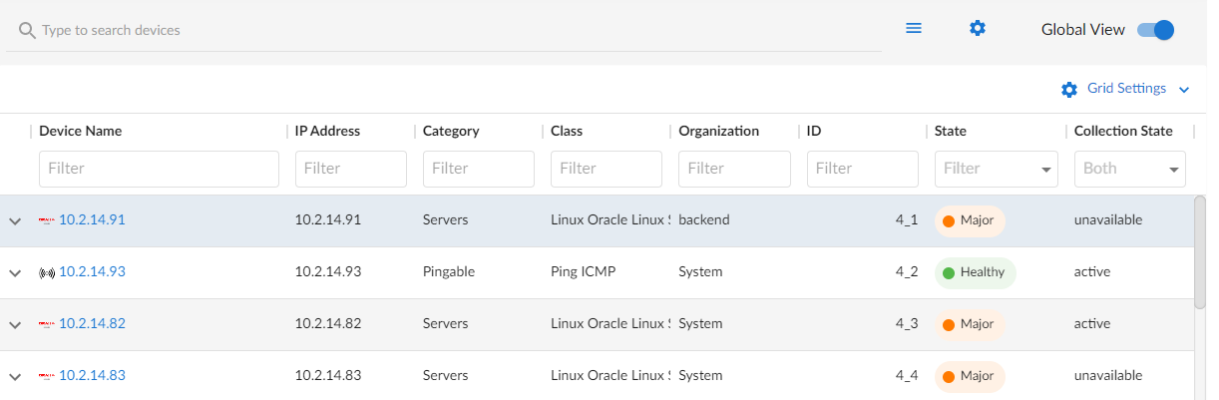

The Devices page set to Global View
In a Global Manager system:
  • When the Global View button on the Devices page is toggled on, you can view a list of all of the devices discovered across all of the stacks in your Global Manager system.
  • When the Global View button on the Devices page is toggled off, you can view a list of devices discovered only on the Global Manager system itself.
You cannot add devices from the Devices page while in Global View mode. You can add devices on a particular stack only while on that stack in non-Global View mode.
If you are looking for a very specific set of devices, click the gear icon (gear icon) to the right of the Search field and select Advanced. In this mode you can create an advanced search using "AND" or "OR" for multiple search criteria. For more information, see Performing an Advanced Search.
You can rearrange the columns in the list by clicking and dragging the column to a new location. You can adjust a column's width by clicking and dragging the right edge of the column. For more information on editing and adding columns, see the topic on Editing the Settings for an Inventory Page.
For each device, the Devices page can display the following information:
  • ID. The Device ID. This is a unique number that Skylar One automatically assigns to the device during discovery.
  • Device Name. Name of the device. For devices running SNMP or with DNS entries, the name is discovered automatically. For devices without SNMP or DNS entries, the device's IP address appears in this field.
  • IP Address. The device's IP address.
  • Class. The manufacturer and type of device. The device class is automatically assigned during discovery, at the same time as the category.
  • Category. The category assigned to the device. Categories include servers, routers, switches, firewalls, and printers, among others. The category is automatically assigned during discovery, at the same time as the device class. For more information about device categories, see the section on Managing Device Classes and Device Categories.
  • Organization. The organization to which the device is assigned.
  • State. The current condition of the device, based upon events generated by the device. The device can have one of the following States:
    • Critical. Device has a serious problem that requires immediate attention.
    • Major. Device has a problem that requires immediate attention.
    • Minor. Device has a less-serious problem.
    • Notice. Device has an informational event associated with it.
    • Healthy. Device is running with no problems.
  • Collection State. The current condition of data collection for the device. The device can have one or more of the following Collection States:
  • Active. Skylar One is collecting data from the device.
  • Unavailable. Skylar One cannot connect to the device. The system cannot collect data from the device until the device is available. A physical device falls back to executing the availability ping every five minutes, unless you have critical ping enabled. Component devices get their availability calculated by the component discovery Dynamic Application of the parent device.
  • User-Disabled. Skylar One is not currently collecting data from the device because a user disabled collection.
  • System-Disabled. Skylar One is not currently collecting data from the device because the system has disabled collection.
  • Scheduled Maintenance. Skylar One is not currently collecting data from the device because it is currently in scheduled maintenance mode.
  • User-Initiated-Maintenance. Skylar One is not currently collecting data from the device because a user manually put it into maintenance mode.
  • Component Vanished. The component device is not currently being reported by its root device. Skylar One cannot collect data from the device at this time.
    Depending on the circumstances, more than one collection state might appear for a single device. For example, if a device is in a scheduled maintenance mode, the Collection State might be Unavailable / Scheduled Maintenance / System-Disabled.
  • Collector Group. The collector group to which the device belongs. Collector groups are groups of Skylar One Data Collectors, which are defined on the Collector Groups page (Manage > Collector Groups).
  • SNMP Credential. The name of the SNMP credential used to monitor the device.
  • SNMP Version. The version of SNMP used to monitor the device.
  • Hostname. The fully qualified hostname for the device, for devices that are discovered and managed by hostname (instead of IP address). This column does not appear by default, but you can add it by clicking Grid Settings > Column Preferences.
  • Date Created. The date and time on which the device was created.
  • Organization ID. The unique numeric identifier of the organization to which the device is assigned.
  • Class ID. The unique numeric identifier of the device class.
  • Category ID. The unique numeric identifier of the device category assigned to the device.
  • Type. The type of device. Options include:
    • Physical. A hardware-based device with an IP address.
    • Component. An entity that runs under the control of a management device.
    • Virtual. A container for collected data.
  • Collector Group ID. The unique numeric identifier of the collector group to which the device belongs.
  • Asset ID. The ID of any asset associated with the device. The asset ID displays as a hyperlink that you can click to view the asset's properties. For more information about assets, see the section on Asset Management.
  • Last Poll. The date and time at which Skylar One last polled the device.
  • Uptime. The amount of time since the device was last initialized.
  • SL Agent. Indicates whether an Skylar One agent is installed on the device. If so, you can click the Yes hyperlink to display a modal where you can update the agent's configuration.
  • Location-based columns. The following columns display information about the device's assigned location:
    • ID (Location). The unique ID of the device's location.
    • Name (Location). The name of the device's location.
    • Latitude (Location). The geographic latitude of the device's location.
    • Longitude (Location). The geographic longitude of the device's location.
    • Street (Location). The street address of the device's location.
    • City (Location). The city where the device's location is located.
    • State (Location). The state where the device's location is located.
    • Zipcode (Location). The ZIP or postal code for the device's location.
    • Country (Location). The country where the device is located.
    • Domestic Region (Location). The regional area with the country where the device is located.
    • Global Region (Location). The broader geographic region where the device is located.
    • Notes (Location). Additional information related to the device's location.
    • Description (Location). A brief description of the device's location.
    • Organizations (Location). The organizations aligned with the device's location.
  • Stack Name. The name of the stack on which the device was discovered.
  • Stack ID. The numeric ID of the stack on which the device was discovered.
If you have defined any custom attributes for your devices, you can also add those custom attributes as columns that appear on the Devices page.

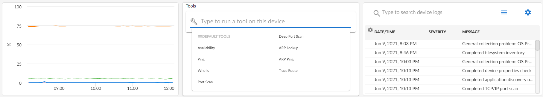

Viewing Additional Data about a Device
On the Devices page, you can click the Expand icon () next to a device name to open a drop-down panel called the Device Drawer. The Device Drawer contains additional data about that device:
Image of the Device Drawer
The Device Drawer contains the Vitals graph pane and the Logs pane.
  • The Vitals pane displays graph data for the past four hours of CPU usage, memory usage, and latency for that device, where relevant. You can zoom in on a shorter time frame in the Vitals graph by clicking and dragging your cursor over a timeframe, and you can go back to the original time span by clicking the Reset zoom button.
  • The Tools pane enables you to run a set of diagnostic tools or user-initiated actions in the Activity Center, or to click on custom links that open in a separate browser window. Click the search bar to search for tools, actions, or custom links that are available for the device. For more information, see the section on Using the Activity Center.
From the list of devices, click the device name to go to the Device Investigator page for more details about that device. For more information, see the Device Investigator section.

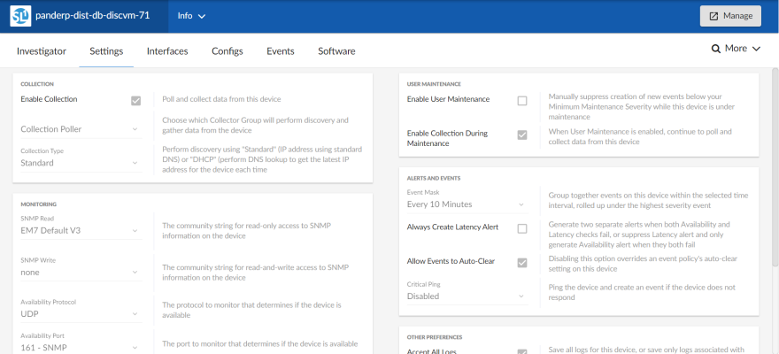

The Device Investigator page contains the following tabs:

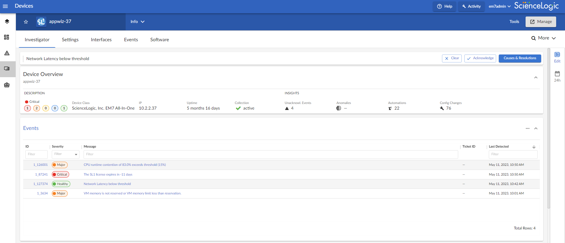

  • Investigator. Displays metrics about a device. For most devices, the default metrics include Logs and the three Vitals: CPU Utilization (percentage), Physical Memory (percentage), and Latency (milliseconds). You can select additional metrics from the Add a metric drop-down list under the Device List pane on the left side of the screen. You can also compare devices on this tab.

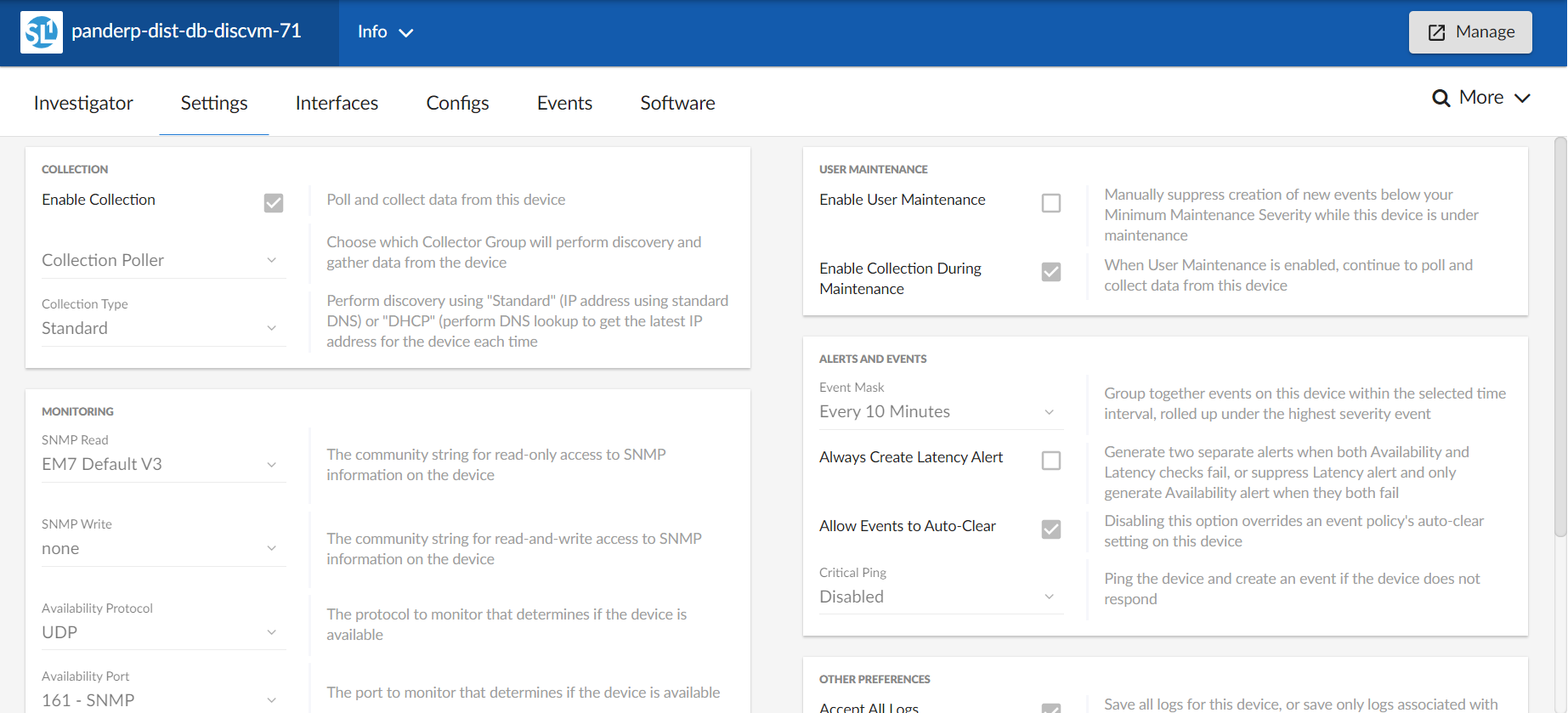

  • Settings. Enables you to manage your preferences for that device, such as whether to auto-clear events, accept all logs, run daily port scans, and more. You can also set user maintenance preferences and disable or enable collection on that device.

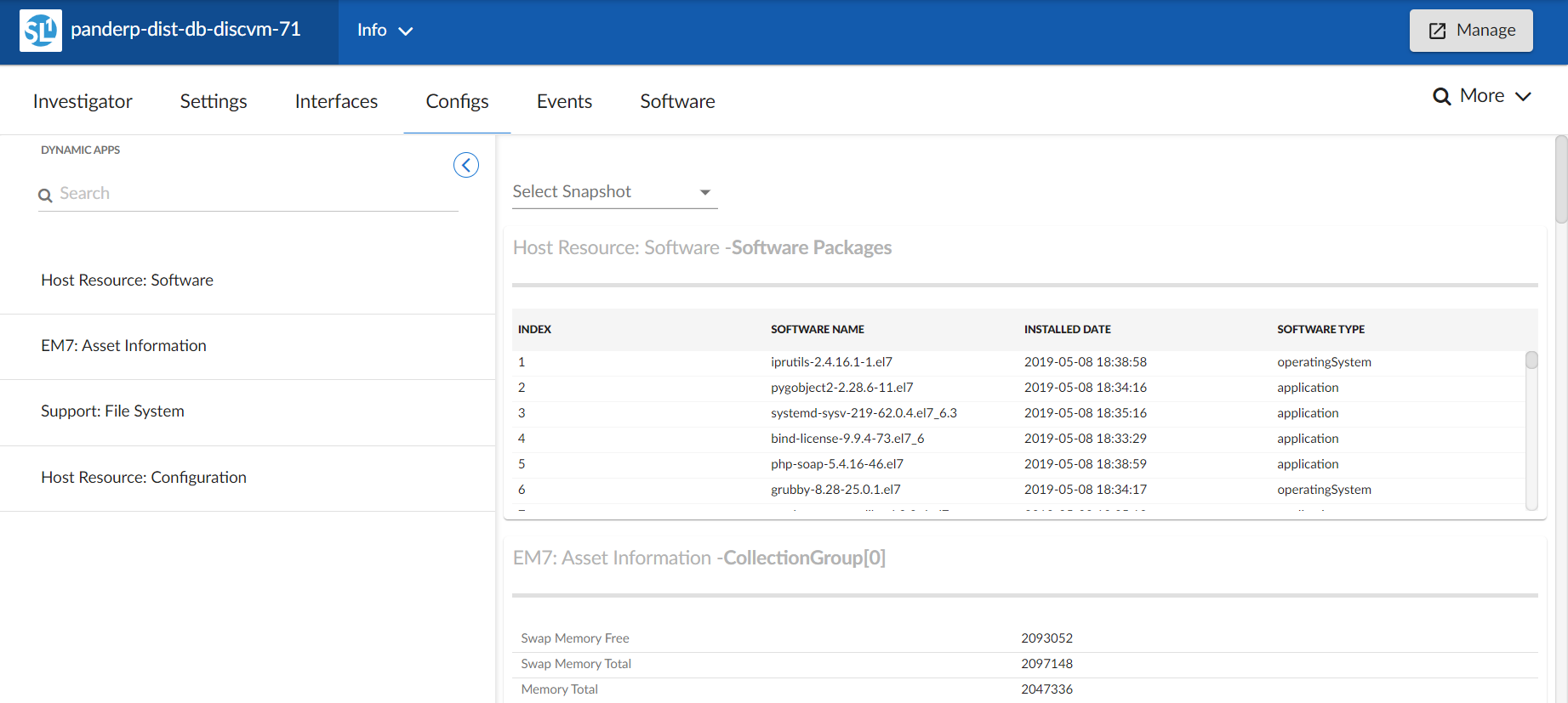

  • Configs. Displays configuration information collected from the device by Dynamic Applications. If the device does not have any configuration data, this tab does not appear.
  • Events. Displays a list of active and cleared events for the device. You can acknowledge events from this tab or add event notes.

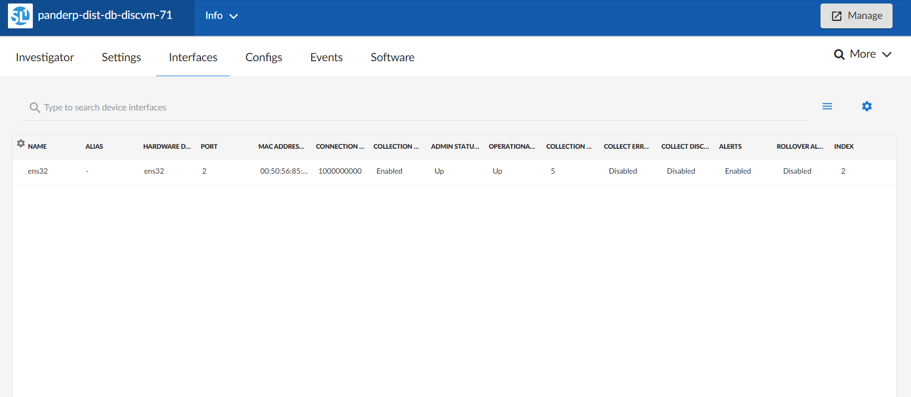

  • Interfaces. Displays information about the interfaces used by the device. If this device does not use interfaces, this tab does not appear.

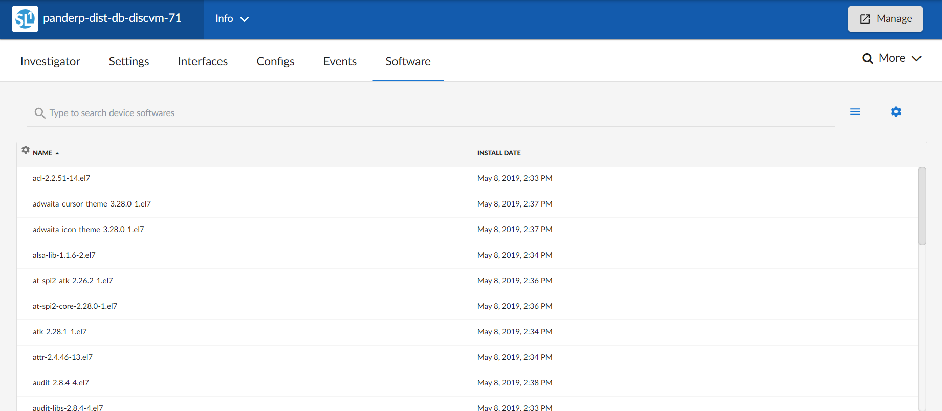

  • Software. Displays a list of all software installed on the device.
  • More. This drop-down list lets you select additional tabs to display on the Device Investigator page by clicking the star icon next to the tab name. You can search for specific items on a tab, and the relevant tab will appear in the search results. You can also remove a tab by clicking the star icon again, turning it from blue to white. Your tab selections are saved and persist until you change them.

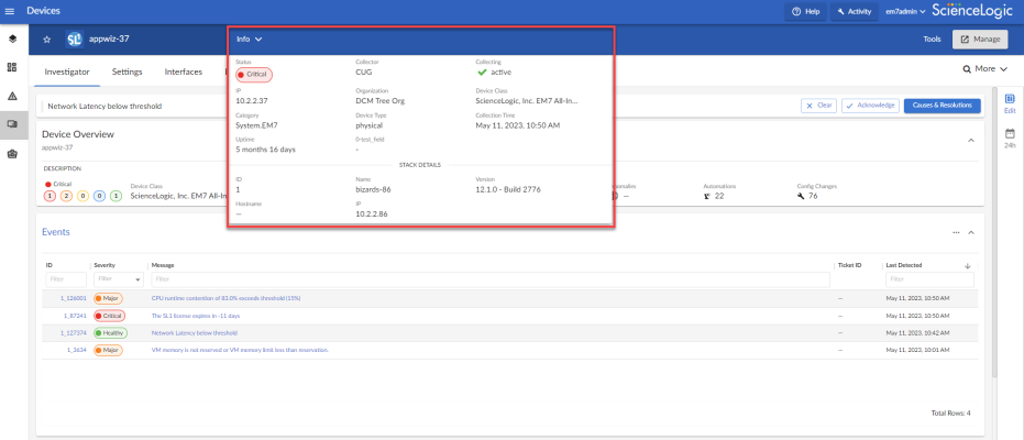

On the Device Investigator page, you can view read-only information about the device in the Info drawer:
The Info drawer displays the following information for the device:
  • Status. The status of the device.
  • Collector. The collector group that was last used to collect data from the device. For All-In-One Appliances, this field contains the name of the default, built-in Collector Group.
  • Collecting. Shows the collection status. A green check mark icon (green check mark icon) means Skylar One periodically collects data from the device. A prohibition icon (prohibition icon) means Skylar One does not currently collect data from the device.
  • IP. IP address of the device.
  • Organization. The organization to which this device belongs. Click the organization name to view a detail page for the organization.
  • Device Class. Device class for the device. A device class usually describes the manufacturer of the device.
  • Category. The device category associated with the device. The device category usually describes the primary function of the device, such as a "server," "switch," or "router."
  • Device Type. Specifies whether the device is a physical device or a virtual device.
  • Location Name. The device's location name as it might appear in a geographic map. Depending on your access, you might be able to edit or only view this field.
  • The Location Name field appears if you have installed AP2 9.13.1-14 (Quesito) or later.
  • Collection Time. Date and time of the most recent collection.
  • Uptime. The number of days and hours that the device has been continuously up and communicating with Skylar One.
  • More Attributes. This lower section lists any custom attributes that might be aligned with this device.
Additionally, the Info drawer also displays the following stack information for devices in Global Manager systems:
  • ID. The numeric ID of the stack on which the device was discovered.
  • Name. The name of the stack on which the device was discovered.
  • Version. The Skylar One (SL1) version running on the stack on which the device was discovered.
  • Hostname. The hostname of the stack on which the device was discovered.
  • IP. The IP address of the stack on which the device was discovered.

The Investigator Tab
The Investigator tab of the Device Investigator page displays a customizable set of metrics about the selected device:
The Device Investigator in Global View mode
The device type determines which metrics appear on the Investigator tab. For most devices, the following panels appear by default:
  • Device Overview. Displays a panel that includes basic information about the device, including its current state, device class, IP address, uptime, collection status, unacknowledged event count, Skylar AI insights, automated actions count, and configuration changes count.
    The device's Skylar AI insights count displays the sum of all open root cause analysis events (accepted, suggested, or custom) plus all open anomaly index score events plus all open predictive alert events. The Skylar AI insights count does not appear if your Skylar One system is not connected to Skylar AI.
  • Events. Displays a panel with the list of events aligned with this device. In the right-hand pane, you can click the ID or Message field to view the Event Investigator page for that event. You can also click the Events panel heading to go to the Events tab for that device.
  • If your device has Skylar Automated RCA suggestions, custom alerts, or accepted alerts, you can click the VIEW link on the banner that appears at the top of the Device Investigator to go to the Events tab for that device to review the Skylar Automated RCA content.
    From the Event Investigator or Service Investigator pages, if you click the name of the device where an event occurred, the Device Investigator for that device opens with an event context panel at the top of the page. From this panel, you can acknowledge, clear, or view causes and resolutions relating to that specific event.
  • Logs. Displays a panel with a list of the logs for the device, sorted from newest to oldest by default. You can use the Search field to search device logs for specific event messages, event IDs, date ranges, source types, and other relevant text for troubleshooting. You can also click the column headers for Date/Time, Source, Event ID, Severity, and Message to sort by that column.
  • Relationships and Membership. Displays a panel that includes details about the other devices that have relationships to the selected device, as well as the device groups and services to which the device belongs or has membership.
    • The Device Relationship tab displays the name, relationship type, relationship discovery method, and health for each device that has a relationship with the selected device. You can click the hyperlink in the Device Name column to go to the Device Investigator for the related device.
    • The Device Groups tab displays the name, device count, and ID for each device group to which the selected device belongs or has membership.
    • The Services tab displays the name, type, status, description, health, availability, and risk for each service to which the selected device belongs or has membership. You can click the hyperlink in the Service Name column to go to the Service Investigator for the related service.
  • Map. Displays a panel with a map of the device and all of the devices with which the device has relationships. You can also click the Map panel heading to go to the Map tab for that device. This panel is off by default. To turn it on, click the Edit button and then select the Map checkbox.
You can customize the appearance of the widgets on the page, including changing their height or width. For more information, see the section on Customizing the Appearance of Widgets on the Investigator Tab.

The Settings Tab
On the Settings tab of the Device Investigator page, you can manage your preferences for that device, such as whether to auto-clear events, accept all logs, run daily port scans, and more.
Click the Edit button to change your settings. When you are done making changes, click Save.
Image of the Settings tab in the Device Investigator
On the Settings tab of the Device Investigator, you can manage your preferences for that device, such as whether to auto-clear events, accept all logs, run daily port scans, and more.
The Settings tab in the Device Investigator
The Agent section appears only for agent-type devices.
Set the following Agent data collection preferences:
  • Disk Space. Specify the amount of disk space in MB that the agent can use to store data. If the agent loses connectivity to Skylar One, the agent uses this disk space to store collected data until the connection to Skylar One returns. When connectivity is re-established, the agent uploads all of its stored data.
  • Excludes. Enter a list of processes and directories, separated by semicolons, that you do not want the agent to monitor.
  • Includes. Enter a list of processes and directories, separated by semicolons, that you want the agent to monitor. Use this field to make sure that the agent monitors specific processes.
    If you list a process or directory in both the Excludes field and the Includes field, the item in the Includes field overrides the item in the Excludes field.
  • Collect File Information. Select this option if you want the agent to report the names of files accessed by each monitored process.
  • Collect Named Pipe Information. Select this option if you want the agent to collect named pipe information.
  • Collect Socket Information. Select this option if you want the agent to collect socket information.
  • Collect Thread Information. Select this option if you want the agent to collect thread information.
  • Collect Non-Intercepted Processes. Select this option if you want the agent to collect limited information for processes that do not contain the agent library.
  • Processes Aggregation. Specify how the agent collects limited information for processes that do not have the agent library. Also specify how the agent aggregates short-lived processes. Your options include the following:
  • All. Aggregate every short-lived process into its parent.
  • None. Do not aggregate any short-lived process.
  • Without Sockets. Aggregate short-lived processes unless those processes have sockets.
  • Upload Interval. Specify how often the agent should upload data. Your options include the following:
  • 20 Seconds. Upload a data snapshot every 20 seconds.
  • 60 Seconds. Upload a data summary every 60 seconds. This is the default setting. This option uses an improved data format that requires fewer Skylar One resources. The Skylar One agent continues to internally collect and poll data every 20 seconds, but the agent summarizes and uploads that data every 60 seconds. There is no data loss even though the data is uploaded less frequently.
    If you specify 60 seconds for the upload interval, the summary upload now includes "watched" or "monitored" files, just like the snapshot upload does.
  • 300 seconds. Upload a data summary every 300 seconds (five minutes).
Set the following Collection preferences:
  • Enable Collection. Select this option to enable collection using the collector group specified in the following field.
  • Collection Poller. Select the name of the collector group that you want to use for collection on this device.
  • Collection Type. Select the type of collection you want to use on this device. Your options include Standard or DHCP.
Set the following Monitoring preferences:
  • SNMP Read. Select the community string for read-only access to SNMP information on the device.
  • SNMP Write. Select the community string for read-and-write access to SNMP information on the device.
  • Availability Protocol. Select the protocol to monitor that determines if the device is available.
  • Availability Port. Select the port to monitor that determines if the device is available.
  • Latency Protocol. Select the protocol to monitor that determines latency for the device.
  • Latency Port. Select the port to monitor that determines latency for the device.
  • Auto-Update. This checkbox specifies whether you want Skylar One to perform a nightly auto-discovery of the device and update records with changes to the device. If you clear this checkbox, Skylar One does not perform auto-discovery. Changes to the device, including newly opened ports, are not recorded by Skylar One.
  • Scan All IPs. If the device uses multiple IP Addresses, Skylar One scans for open ports on all IPs during initial discovery and nightly auto-discovery.
Set the following Topology preferences:
The device initially uses the system-wide topology settings that you set on the Behavior Settings page (System > Settings > Behavior), or from the topology settings for the device's class. You can change these settings for one device by editing one or more of the following fields. For more information about the system-wide topology settings, see the section on Global Settings for System Behavior. For more information about the device class topology settings, see the section on Device Classes and Device Categories.
  • L2. Select the Override checkbox to override the system-wide Layer-2 topology settings that are set on the Behavior Settings page (System > Settings > Behavior). When selected, this field becomes editable, and you can select from the following options:
    • Disabled. Disables Layer-2 topology collection and processing for the device.
    • Processing Enabled. Enables Layer-2 topology processing for the device. The "Enterprise Database: Topology Crunch" process determines Layer-2 topology relationships based on device category and connects network devices to each other using methods other than the standard SNMP protocol for collection.
    • Collection and Processing Enabled. Enables Layer-2 topology collection and processing for the device. The system uses the standard SNMP collection methods and the "Enterprise Database: Topology Crunch" process to determine Layer-2 topology relationships based on device category, with the purpose of connecting network devices to each other.
    • Enhanced Processing Enabled. Enables advanced Layer-2 topology processing for the device, but using methods other than the standard SNMP for collection. This enhanced processing can form Layer-2 relationships between any devices that match a MAC address from the BRIDGE-MIB or are sourced from Dynamic Applications, regardless of device category.
    • Collection and Enhanced Processing Enabled. Enables advanced Layer-2 topology processing and collection for the device using the standard SNMP collection methods. This enhanced processing can form Layer-2 relationships between any devices that match a MAC address from the BRIDGE-MIB or are sourced from Dynamic Applications, regardless of device category.
  • L3. Select the Override checkbox to override the system-wide Layer-3 topology settings that are set on the Behavior Settings page (System > Settings > Behavior). When selected, this field becomes editable, and you can select from the following options:
    • Disabled. Disables Layer-3 topology collection and processing for the device.
    • Processing Enabled. Enables Layer-3 topology processing for the device using the "Enterprise Database: Topology Crunch" process to determine Layer-3 topology relationships. This option requires all hops in a traceroute to respond and match devices within Skylar One to form the relationship.
    • Collection and Processing Enabled. Enables Layer-3 topology collection and processing for the device using the "Enterprise Database: Topology Crunch" process to determine Layer-3 topology relationships. This option requires all hops in a traceroute to respond and match devices within Skylar One to form the relationship.
    • Enhanced Processing Enabled. Enables advanced Layer-3 topology processing for the device, where the system forms relationships between any two hops that respond and match devices in Skylar One rather than discarding incomplete traceroutes or results that include unmatched hops.
    • Collection and Enhanced Processing Enabled. Enables advanced Layer-3 topology processing and collection for the device, where the system forms relationships between any two hops that respond and match devices in Skylar One rather than discarding incomplete traceroutes or results that include unmatched hops.
  • CDP. Select the Override checkbox to override the system-wide Cisco Discovery Protocol (CDP) topology settings that are set on the Behavior Settings page (System > Settings > Behavior). When selected, this field becomes editable, and you can select from the following options:
    • Disabled. Disables CDP topology collection and processing for the device.
    • Processing Enabled. Enables CDP topology processing for the device. The "Enterprise Database: Topology Crunch" process determines CDP topology relationships between two devices that both respond with CDP neighbor data, show each other as neighbors, and are managed devices in Skylar One. This option uses methods other than standard SNMP for collection.
    • Collection and Processing Enabled. Enables CDP topology collection and processing for the device. The system uses standard SNMP collection methods and the "Enterprise Database: Topology Crunch" process to determine CDP topology relationships between two devices that both respond with CDP neighbor data, show each other as neighbors, and are managed devices in Skylar One.
    • Enhanced Processing Enabled. Enables advanced CDP topology processing for the device, but using methods other than standard SNMP for collection. This advanced processing can form CDP relationships between two devices if at least one of those devices responds with CDP neighbor data and is a managed device in Skylar One.
    • Collection and Enhanced Processing Enabled. Enables advanced CDP topology processing and collection for the device using standard SNMP collection methods. This enhanced processing can form CDP relationships between two devices if at least one of those devices responds with CDP neighbor data and is a managed device in Skylar One.
  • LLDP. Select the Override checkbox to override the system-wide Link Layer Discovery Protocol (LLDP) topology settings that are set on the Behavior Settings page (System > Settings > Behavior). When selected, this field becomes editable, and you can select from the following options:
    • Disabled. Disables LLDP topology collection and processing for the device.
    • Processing Enabled. Enables LLDP topology processing for the device. The "Enterprise Database: Topology Crunch" process determines LLDP topology relationships between two devices that both respond with LLDP neighbor data, show each other as neighbors, and are managed devices in Skylar One. This option uses methods other than standard SNMP for collection.
    • Collection and Processing Enabled. Enables LLDP topology collection and processing for the device. The system uses standard SNMP collection methods and the "Enterprise Database: Topology Crunch" process to determine LLDP topology relationships between two devices that both respond with LLDP neighbor data, show each other as neighbors, and are managed devices in Skylar One.
    • Enhanced Processing Enabled. Enables advanced LLDP topology processing for the device, but using methods other than standard SNMP for collection. This enhanced processing can form LLDP relationships between two devices if at least one of those devices responds with LLDP neighbor data and is a managed device in Skylar One.
    • Collection and Enhanced Processing Enabled. Enables advanced LLDP topology processing and collection for the device, using the standard SNMP collection methods. This enhanced processing can form LLDP relationships between two devices if at least one of those devices responds with LLDP neighbor data and is a managed device in Skylar One.
Set the following User Maintenance preferences:
  • Enable User Maintenance. Specifies whether the device is in user maintenance mode. User maintenance is an option that allows a user to manually put a device into "maintenance mode". During maintenance mode, for the selected devices, Skylar One generates only events with a severity less than the system-wide Maintenance Minimum Severity setting. If you select Enabled, the device is put in user maintenance mode, and the device remains in this state until you or another user disables user maintenance mode.
  • Enable Collection During Maintenance. Specifies whether Skylar One polls the device when user maintenance mode is enabled. If you select Enabled, Skylar One continues to poll and collect data from this device during user maintenance mode.
Set the following Alerts and Events preferences:
  • Event Mask. Specify the time frame for masking events. When a device uses the Event Mask setting, Skylar One groups together events that occur on that device within the specified span of time.
  • Always Create Latency Alert. Select this option to generate two alerts when availability and latency checks fail. Clear this checkbox to generate only an availability alert and suppress latency alerts.
  • Allow Events to Auto-Clear. Clear this checkbox to override an event policy's auto-clear setting for this device.
  • Critical Ping. Pings the device and creates an event if the device does not respond. When enabled, you can select between five and 120 seconds.
Set the following Other device preferences:
  • Accept All Logs. This checkbox specifies whether you want to keep and save all logs for this device. If you want to retain only logs associated with events, clear this checkbox.
  • Daily Port Scans. This checkbox specifies whether you want Skylar One to perform a daily scan of the device for open ports.
  • Preserve Device Name. If you select this checkbox, the name of the device in Skylar One remains the same, even if the name of the actual device changes. If you clear this checkbox, the Skylar One name for the device updates if the name of the actual device changes.
  • Disable Asset Update. If selected, Skylar One does not automatically create a new asset record for the device or update the existing asset record for the device. For the single device, this checkbox overrides any settings defined on the Asset Automation page (System > Settings > Assets).
  • Bypass Interface Inventory. Specifies whether the discovery session should discover network interfaces. Your options include:
  • Selected. Skylar One does not attempt to discover interfaces for this device during rediscovery and nightly auto-discovery.
  • Not Selected. Skylar One attempts to discover network interfaces for this device during rediscovery and nightly auto-discovery using the Interface Inventory Timeout value and Maximum Allowed Interfaces value specified on the Device Thresholds page.
  • Dynamic Discovery. If selected, Skylar One automatically assigns the appropriate Dynamic Applications to the device during discovery.
The Configs Tab
On the Configs tab of the Device Investigator, you can view configuration information that the system collects from the device through Dynamic Applications. You can also view a list of all changes that occurred with a Dynamic Application between two specific snapshot reference points.
Image of the Configs tab on the Device Investigator page
You can find all "config" objects on the Configs tab. Usually, "config" objects contain static information about hardware and configuration settings, such as serial numbers, version numbers, and hardware status.
For more information about this tab, see the section on Viewing Device Configuration Data.

The Interfaces Tab
On the Interfaces tab of the Device Investigator, you can view information about the various interfaces used by the device, including Port, Hardware Description, MAC Address, Connection Speed, and other details for each interface.
The Interfaces tab of the Device Investigator page
For more information on the Interfaces tab, see the section on Viewing Interfaces for a Single Device.
The Software Tab
On the Software tab of the Device Investigator, you can view a list of all the software installed on the device.
The Software tab of the Device Investigator page
For each installed software title, the Software tab displays the following information:
  • Name. Name of the software.
  • Install Date. Date and time the software was installed on the device.
For more information about this tab, see the section on Monitoring Hardware and Software.
